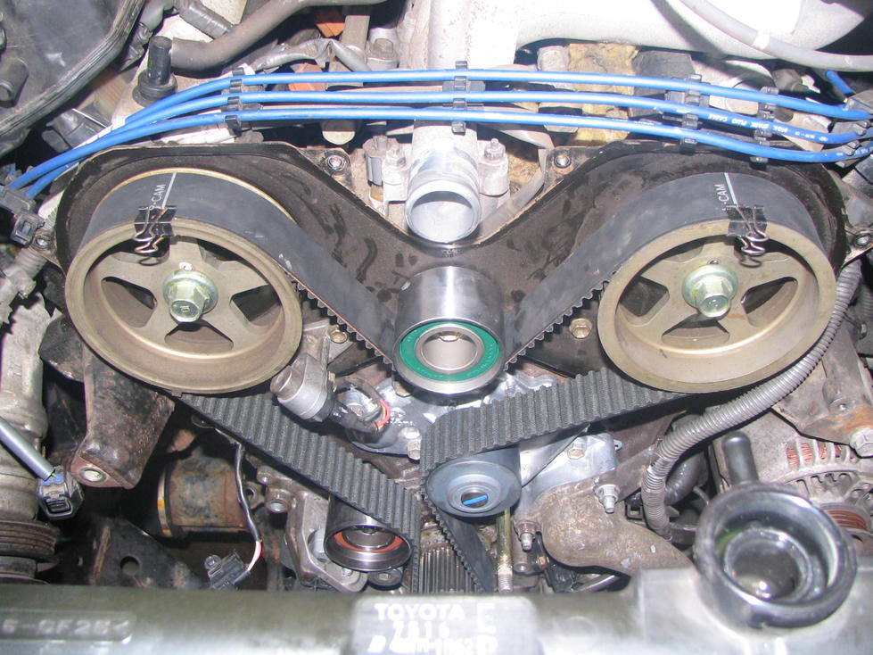

The hardest thing for me was getting the new timing belt on. I had to get my 6'5" neighbor to help me slip the belt under the top idler pulley. Make sure to line up the crank at 12 oclock and if the notched line on each cam does not line up exactly with the notch in the cover plate, don't worry. If the paint marks match, then you are good to go.The R cam gear will more than likely move forward just a little when there is a great deal of tension is exerted on the new belt to get it under the idler.

The trick with that is loosen the top idler bolt a few turns until it tilts up a few degrees, slip the belt on, then tighten bolt, then pull tensioner pin. A few binder clips are fantastic for keeping the belt in place on the pulleys.(My own invention!) See attached.
