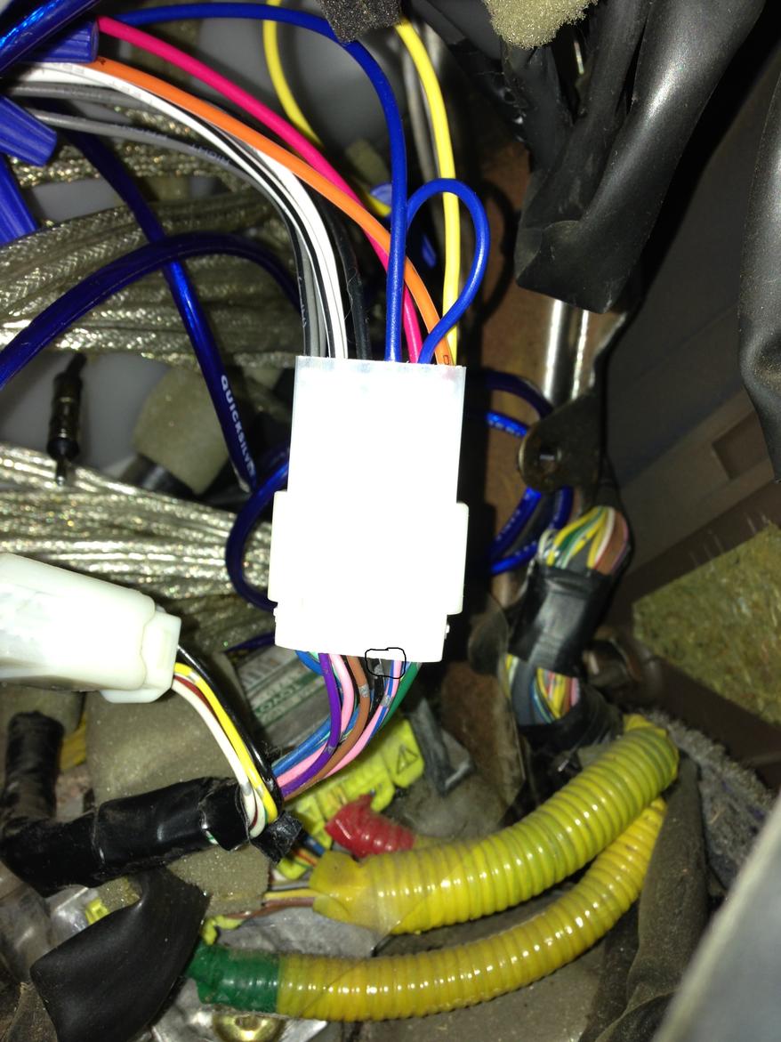

Well Im an idiot. The blue one is of course for the aftermarket radio. Here is the connector for the stock harness. Notice the black/white wire and then the pink/blue. On the aftermarket harness there is the blue one that connects to the aftermarket radio and then there is a blue loop that goes from the remote/power antenna wire back in to the connector next to it which then goes to the pink/blue. I connected my switch from the blue of the aftermarket radio to my own wire that goes to my switch and then from the switch to the blue of the aftermarket harness which connects to the black/white.

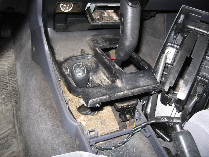

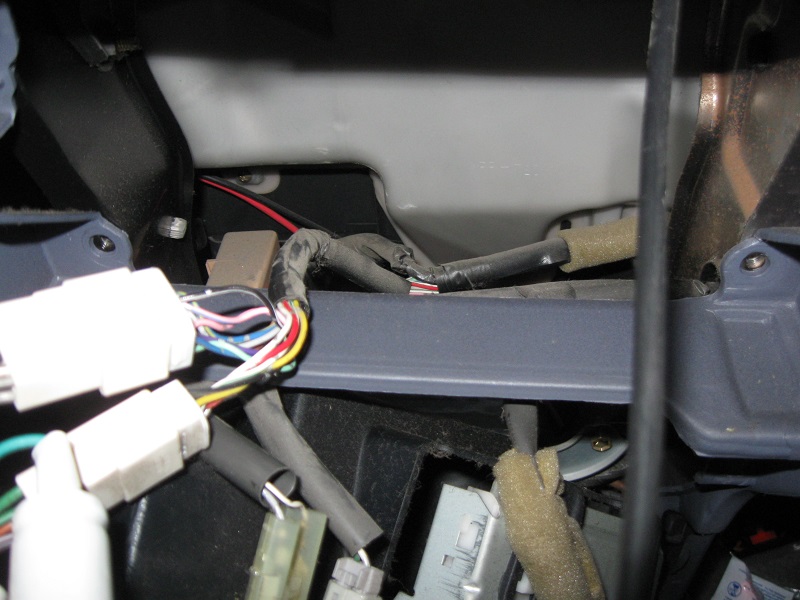

Updating this so it might help someone else. On my 96 it was super easy.

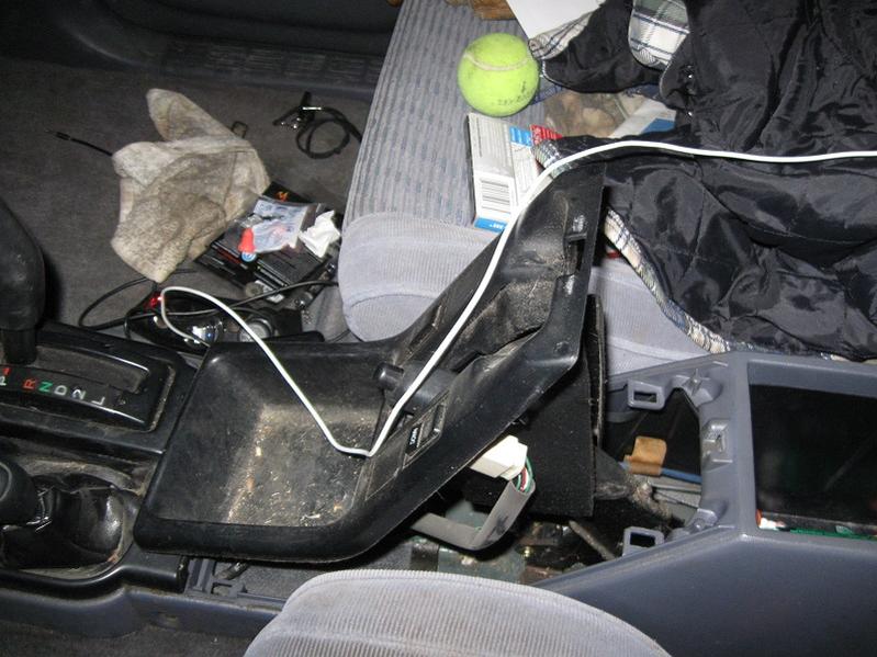

1. Pop the E brake cover loose and move it to the side. No tools needed.
2. Pop the shifter cover over and move it up and back a little.

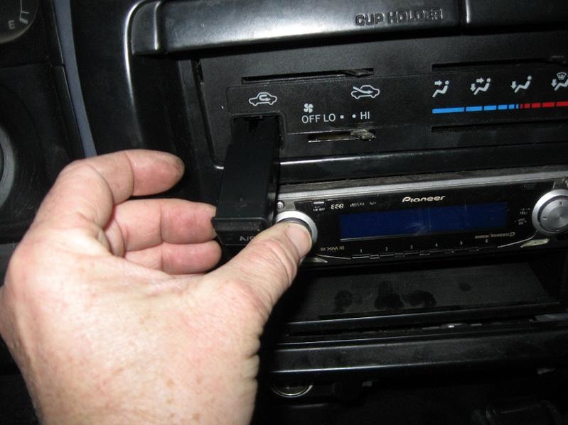

3. Pull out the AC switch and knobs off the heater control slides.

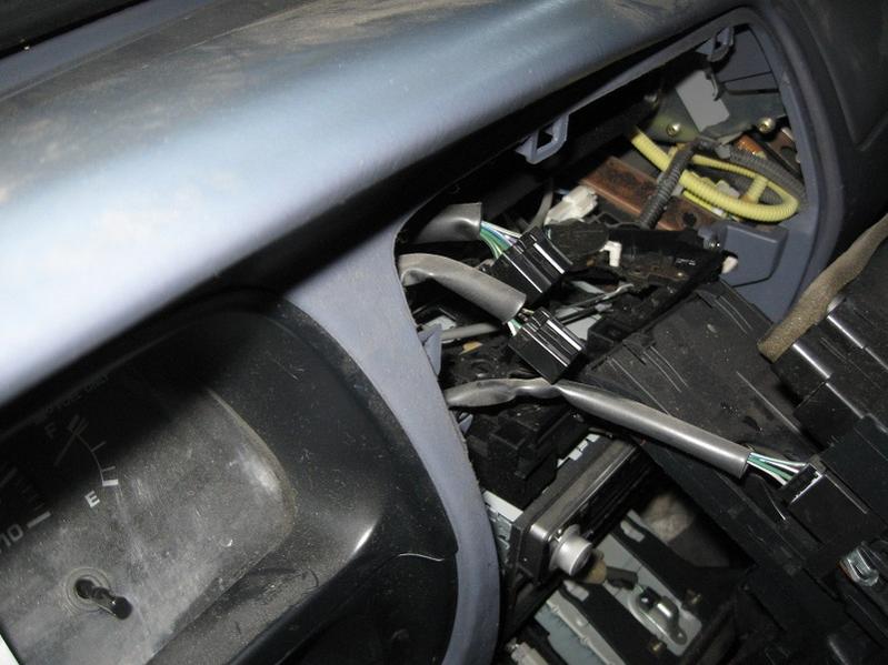

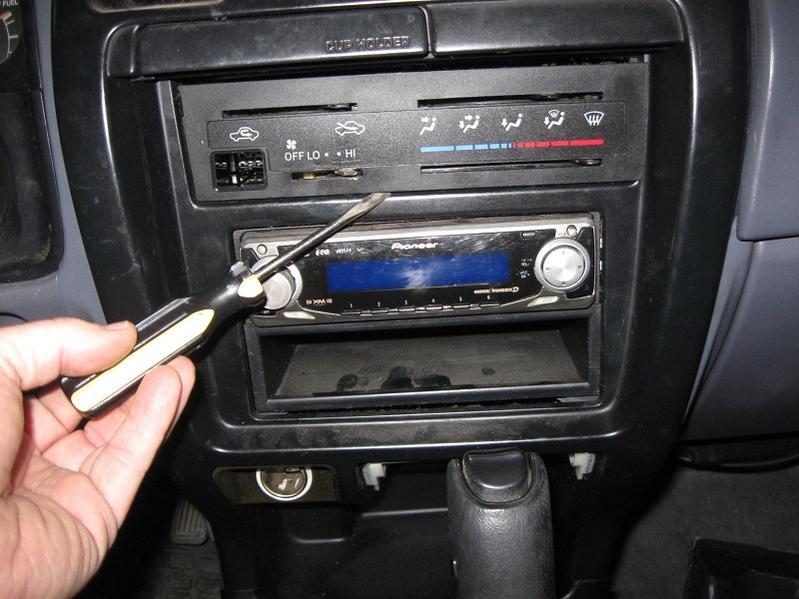

5. Lightly pry off the cover and take out the two screws holding the bezel in place.

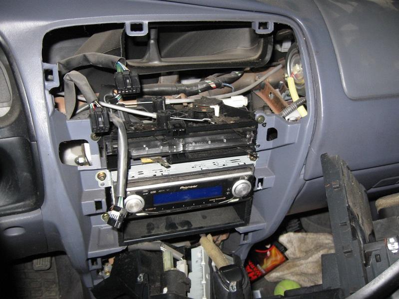

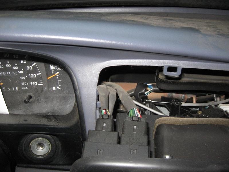

6. Unplug the two top plugs and the radio plug below them lay panel out of the way.
7. Find black and white wire on the larger plug. I cut back the factory sheathing to allow more access. I also cut this wire because then the switch is working regardless of what radio is installed now or later.
8. Wire in a simple on off switch of your choice and locate it where you want.
9. Put things back in reverse.
10. Have a beer and enjoy a simple but useful mod.
