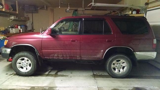

A quick shot in the garage. It sits about 36" ground to fender F/R. Don't hate on my tiny snow tires too much, I bought them before body/suspension lift so they didn't look that bad at stock height. They're 245's, I got a good deal on them.
Looks good.

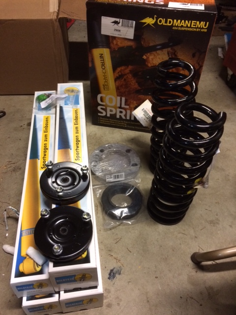

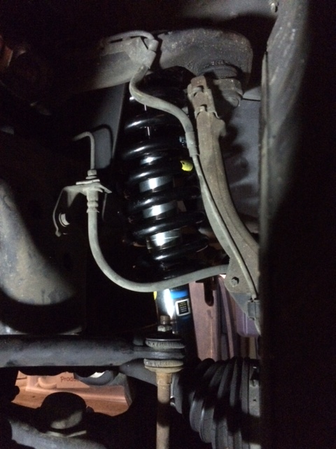

I just finished almost the same lift last night. I still have the rear to do. Went with the tundra bilsteins all around and TRD tundra coils upfront.

coils
