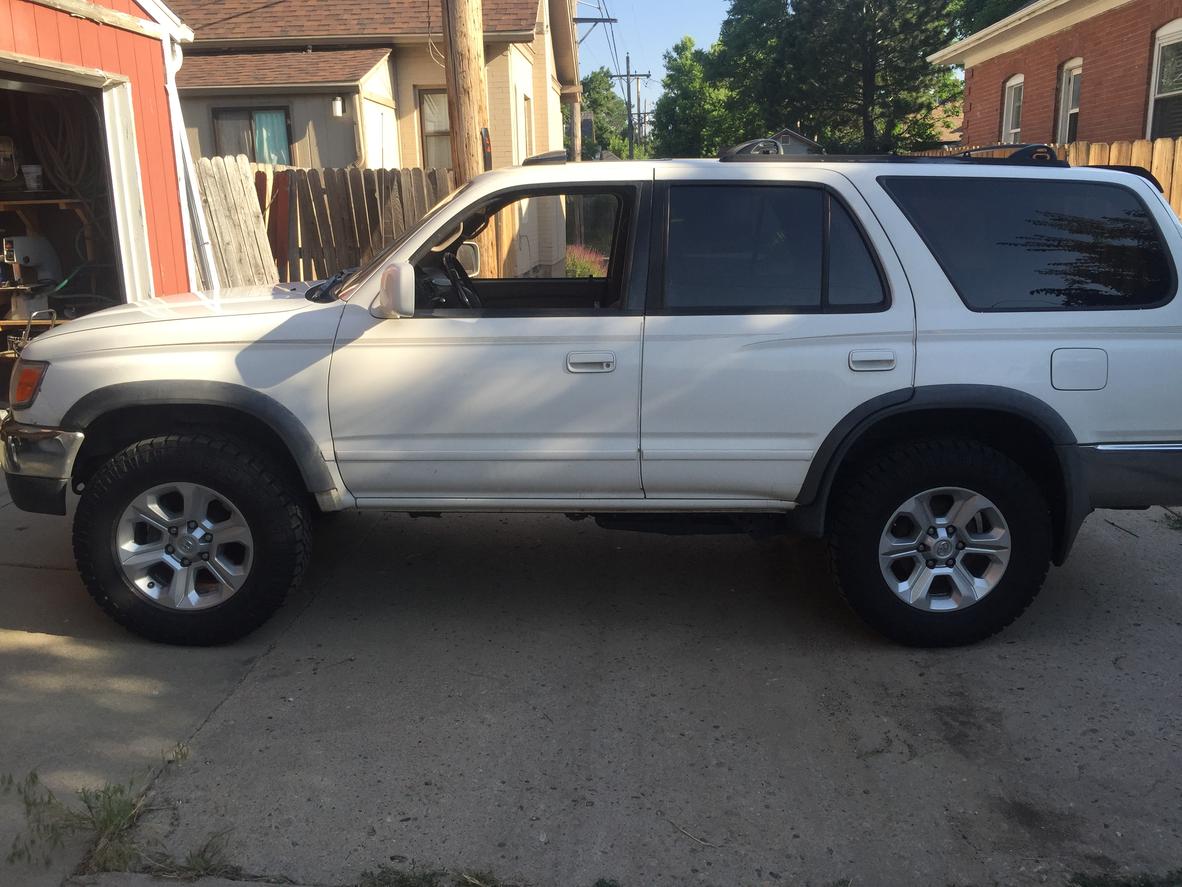

So I have been toying with the idea of removing the running boards. Removed the drivers side this evening. Looks pretty good ! Only thing I don't like is the trailing edge of the flare for front wheel. Guess I need to look into this and what's available. Didn't realize how easy the boards come off. Lol.

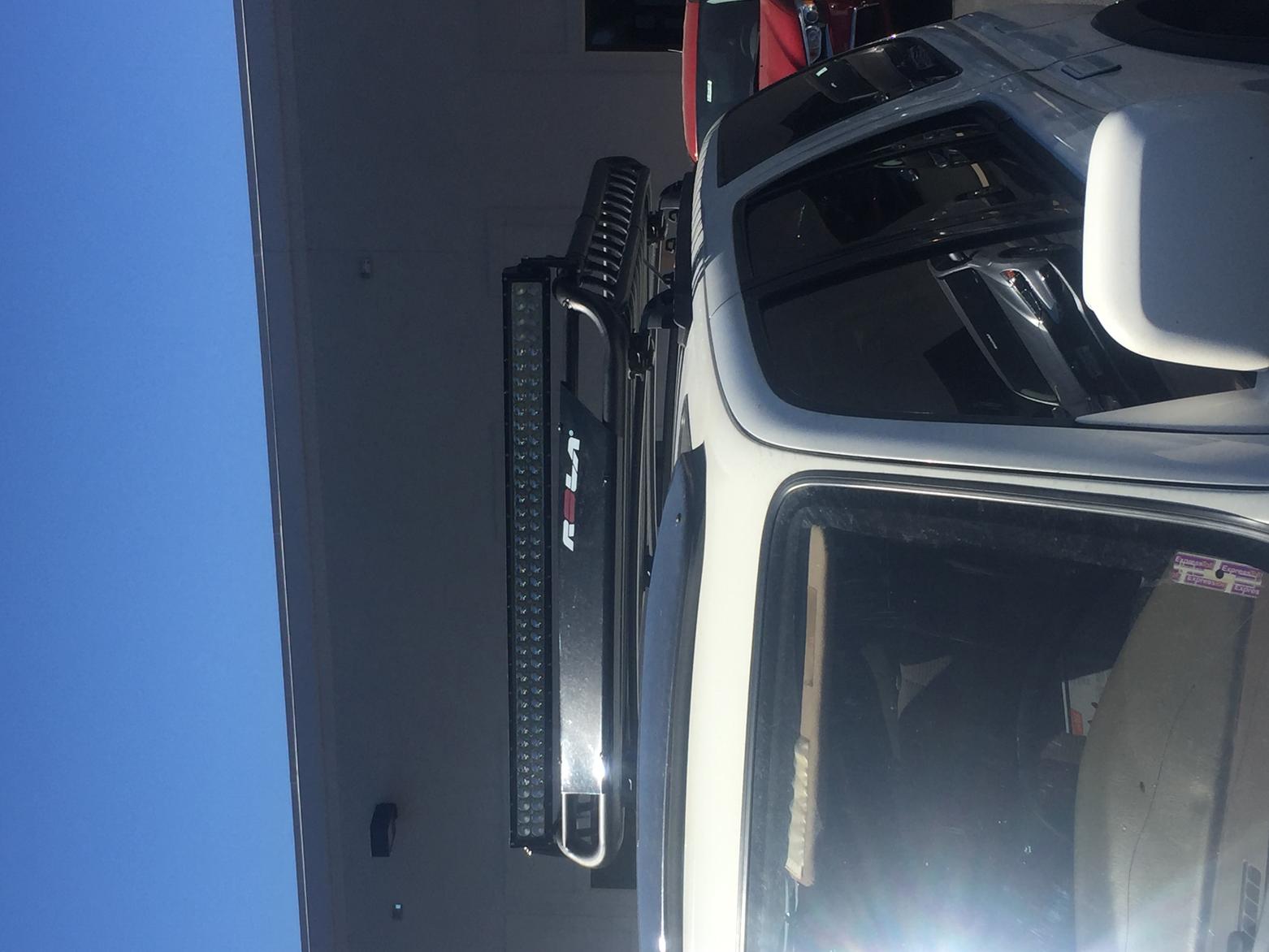

How do you like the light bar being mounted in the stock bumper? Does it vibrate a lot when offroading? On my old taco, I did a similar setup but the lights were bouncing around everywhere!
The light bar is mounted very solid and does not bounce. Been very happy with it.

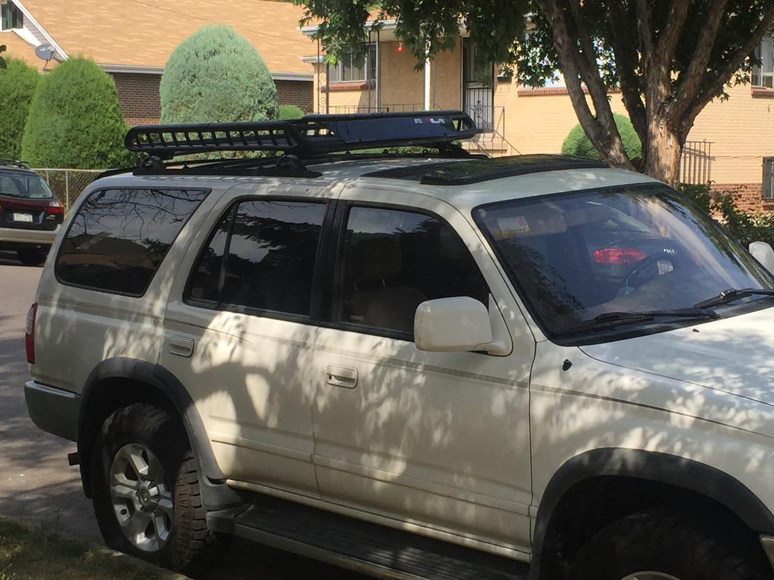

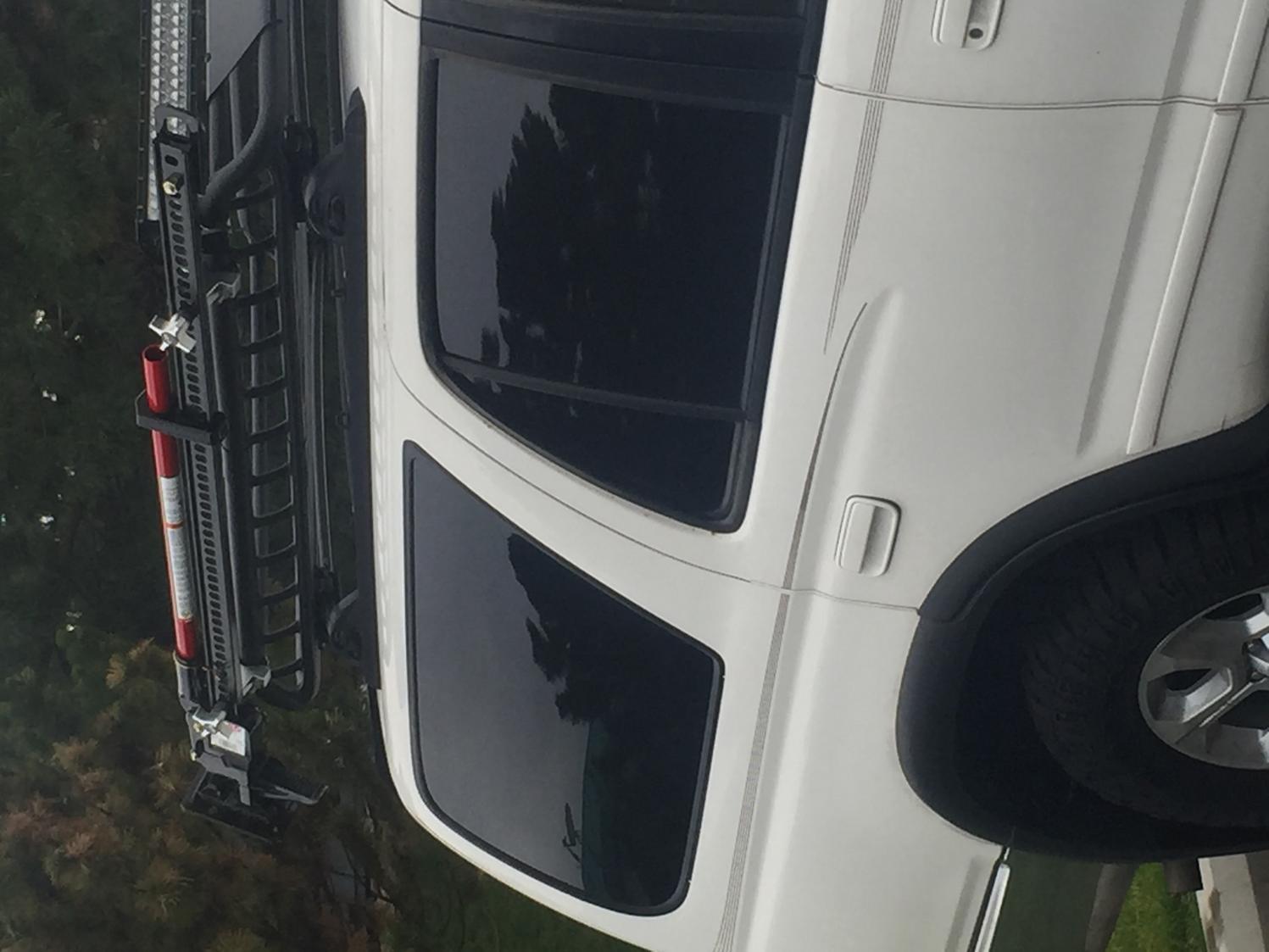

So this is a Rola rack purchased from Amazon. First thoughts, this was super easy to assemble! Phillips screwdriver the only tool required. I unpacked and had it installed in under a half hour. It seems pretty stout and imagine that the only limiting factor as far as weight goes would be your factory cross bars. This morning was the first time I had it at highway speeds and I didn't hear any additional noise being created by the rack ! So far very pleased. Next up is mounting my other light bar and figuring out how to mount my high lift to it. Stay tuned.

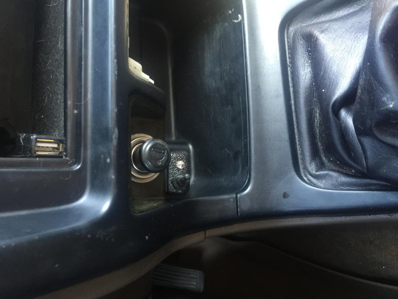

Got my antenna switch in today also. Now I can jam out and not get the antenna ripped off.

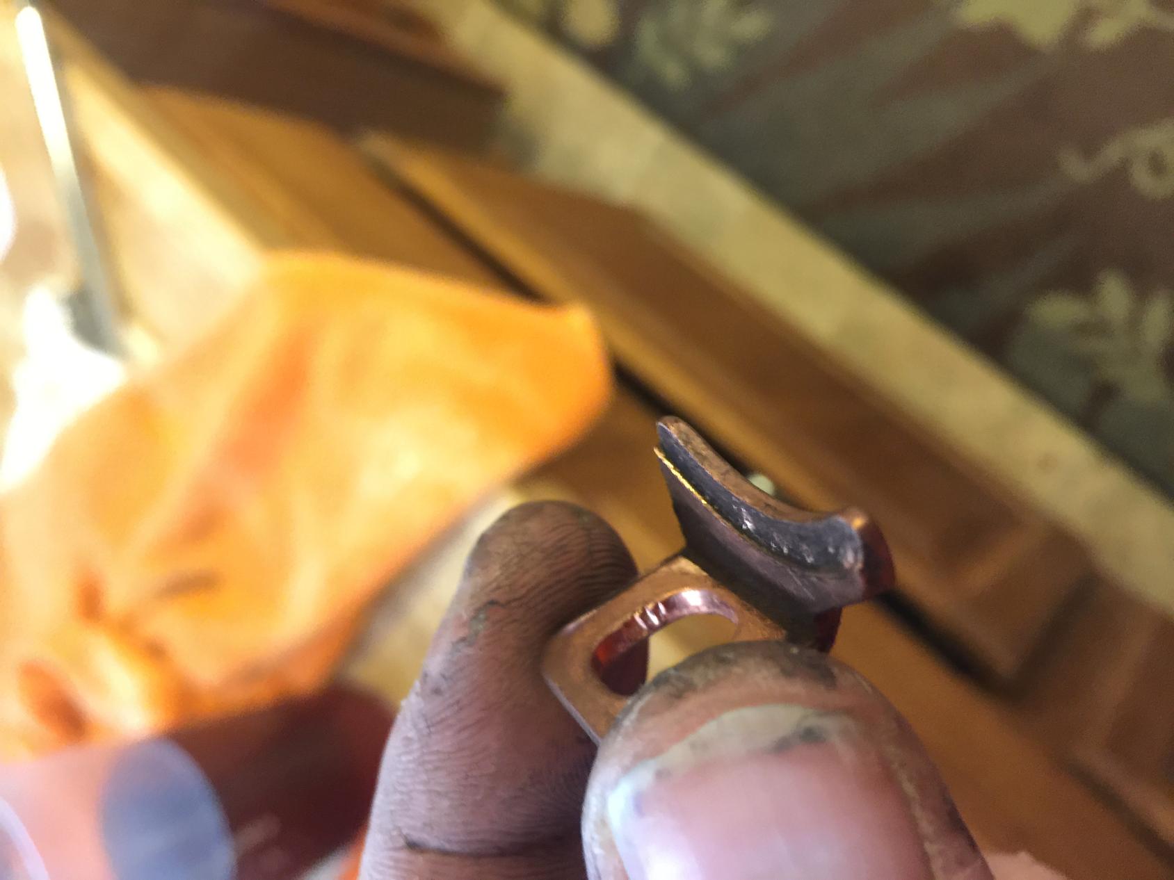

So a couple days ago I had to replace the starter contacts. Truck had been randomly not cranking on first attempt. Sometimes second key turn and it would crank, sometimes 5. Had heard the 'horror' stories about how hard starter was to pull but went at it anyway in the driveway in 5deg cold. Starter can be pulled with out jacking truck or pulling right front wheel. I have no lift just had to slide under there. Disconnect battery , Pull rubber fender liner, remove main starter wire and small electrical connector, remove exhaust bracket, loosened brake line retainers ( no need to open brake system). Remove 2 bolts retaining starter. I had bought a couple long extensions while at the parts store for the contacts but didn't even need them as some people suggested. You do have to get the starter positioned just right for removal through fender/wheelwell but it will fit. Replaced contacts and had it all back together in 1.5 hrs tops. Starter contacts were worn out and needed replaced. No one had a plunger in town so after inspecting it I just cleaned it up with some emery paper. Has been working great now! Hasn't shown symptoms since replacement. 213.5k 12/18/2016
