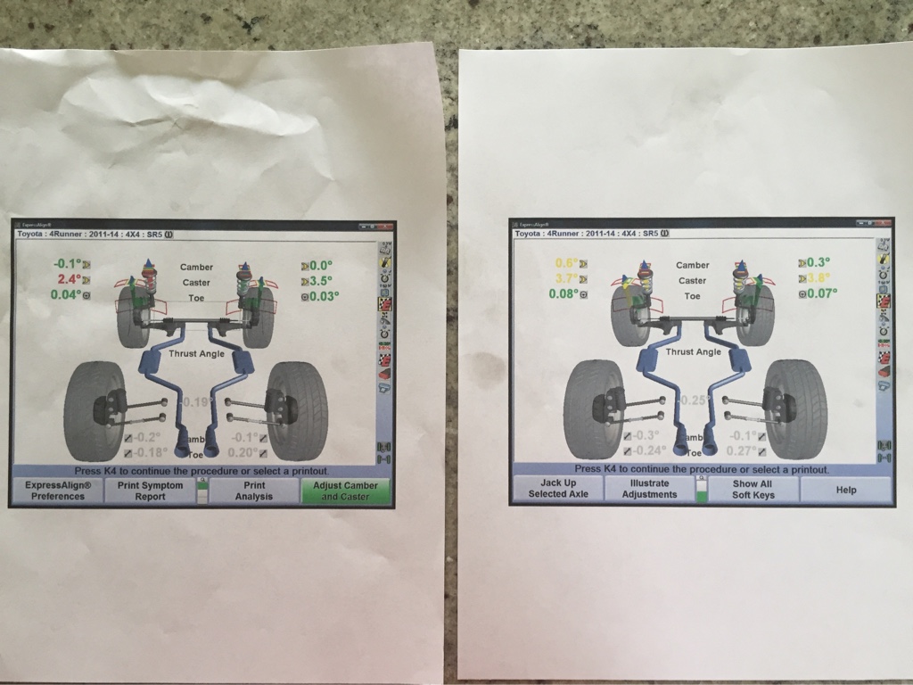

Just took my car to a Goodyear shop and got my alignment told them I would like my caster at 4 and right away he advised against it. Tech said that due to the way the road was built the right caster needs to be slightly higher than the left. .2 degrees or so. Long story short and he brought my caster up the camber turned red and he brought it as close as he could to 4. The photo is the before and after but my car is now pulling slightly right. Can someone advice on this or is this normal. I have 5100 up front and it set to second ring which I think is at .75 or near that number and back are stock.
the tech is correct in that typically there is a caster split to account for road crown. however, it looks to me like your truck "should" pull to the left slightly. camber pulls positive (left side is more positive and should pull that direction) and caster "pushes" negative. again, caster is slightly lower on the left, so it should pull that direction.
unless you mean your steering wheel is off to the right? :noidea: did they adjust toe at all?
i'm not sure if they adjusted the toe, but the car pulls to the right. when driving and i let go of the steering wheel, the vehicle just goes to the right.
Take it back and let them know your issue. even if the readings are within specifications, there can be special circumstances causing your pull or drift to the right. Have him lower your left side caster a bit and then try it again.
Toe angles will go out of adjustment if caster or camber are adjusted, shoot toe may deviate slightly from pulling the car off the rack and back on, so toe adjustments may always be needed.
One other thing, tell him to please give you a before and after printout with bar graphs instead of the screen shots. These print outs will give you the true readings, and the shop needs to verify caster after all adjustments. So the screen shot on your print out may actually be different from the actual caster readings on your truck.
thanks, ill be taking it back.
