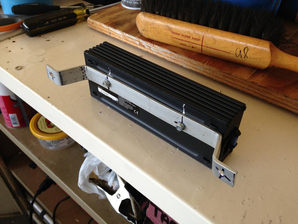

I mounted the Alpine thing in the copious free space behind and below the radio. Fabbed a bracket out of hobby shop Aluminium bar.
