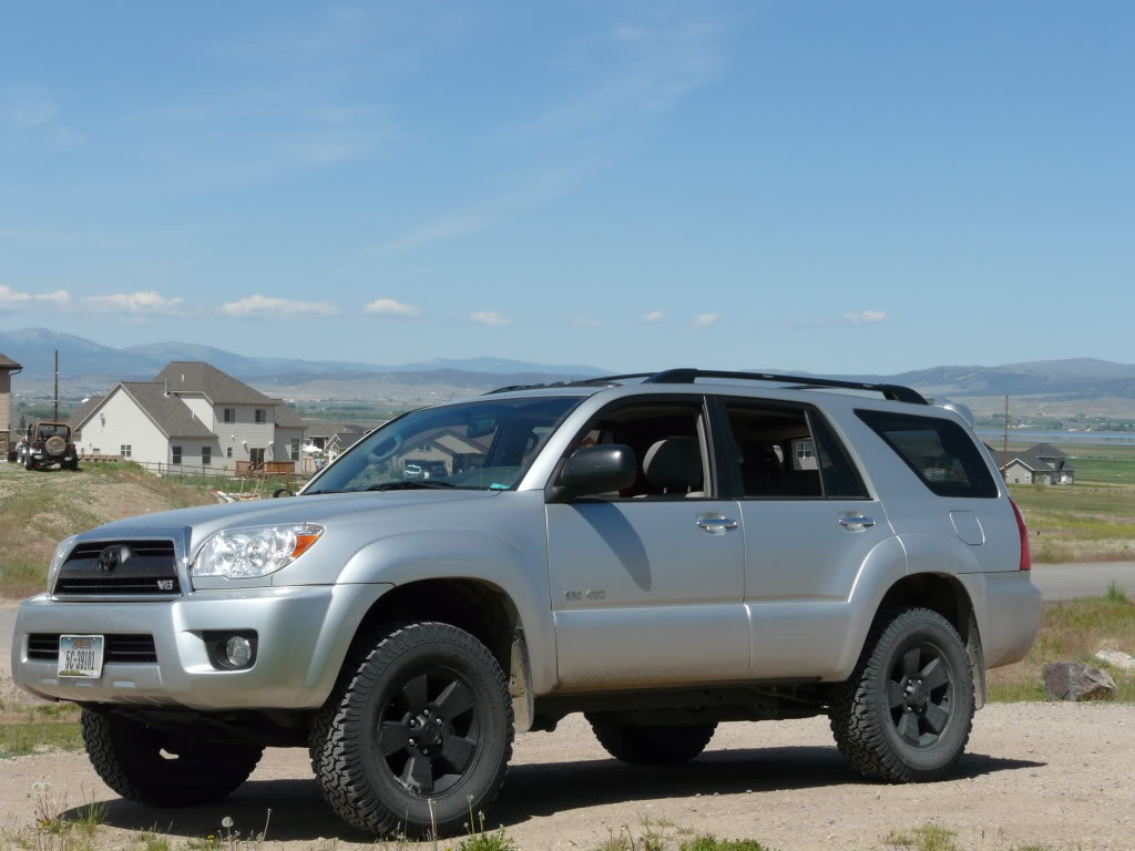

Anyone know the stock backspacing on these wheels?

From what I've read it's ~5"
17x7.5
Offset= +30mm (~1.18")
Backspacing=7.5"/2=3.75" .. 3.75" + 1.18"= 4.93"
I'm pretty sure you don't subtract that because the backspacing and offset are measured from the back of the mounting pad. But I could be wrong.

LOL, yeah, i just found it and put it in there in the 4th gen section. It gave me 5.5" BS which I hope is wrong :) I'm hoping for 4.5 so I don't have to get a 1" spacer up front.
edit: After playing around more with the wheel calculator I see the mounting pad is the only point of interest which only makes sense so it looks like 5.5" is my backspacing....crap.
Yeah, I've been looking for wheels and noticed that with the calculator too. I don't know why it says 5.5".
I think you'll want spacers if you get those wheels though. Most 4th gen owners prefer the spacers with them or wheels with 4.5" backspacing.
