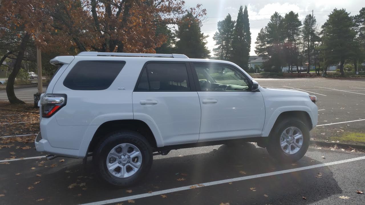

Just picked up a 2016 SR5. Already have a 2015 Tacoma so decided to get a 4 Runner for the wife. I plan to get some rims and tires but can't decide on the offset.
Option #1 - Method Grid 17x8.5 with 0 offset 4.75" BS
Option #2 - Stealth Custom Series RAY10 17x8.5 with -10 offset 4.30" BS
Going to keep it stock height and run 265/70/17 KO2s. Wondering if I will have any issues with the 0 or -10 offset? If anyone has some pics of how much a 0 and -10 offset sticks out that would be great. Would like to get the tire flush with the fender. I read the sticky and I think either offset will work. But post up some pics!
Thanks.

Also have a look here. Hopefully someone can chime in on the specific offsets you are inquiring about but I do know with stock offset and backspacing some have rub while others do not.
Most often the only way to know is to just do it. Crazy, I know.. But hey..at least it's suspenseful. :whoo:
http://www.toyota-4runner.org/5th-g...c-bfg-ko2-275-70r17-your-4r-without-lift.html
Thanks. Yeah I checked out that thread. Looks like it doesn't get much traffic.:ohwell: Figure I'd post it up here.
