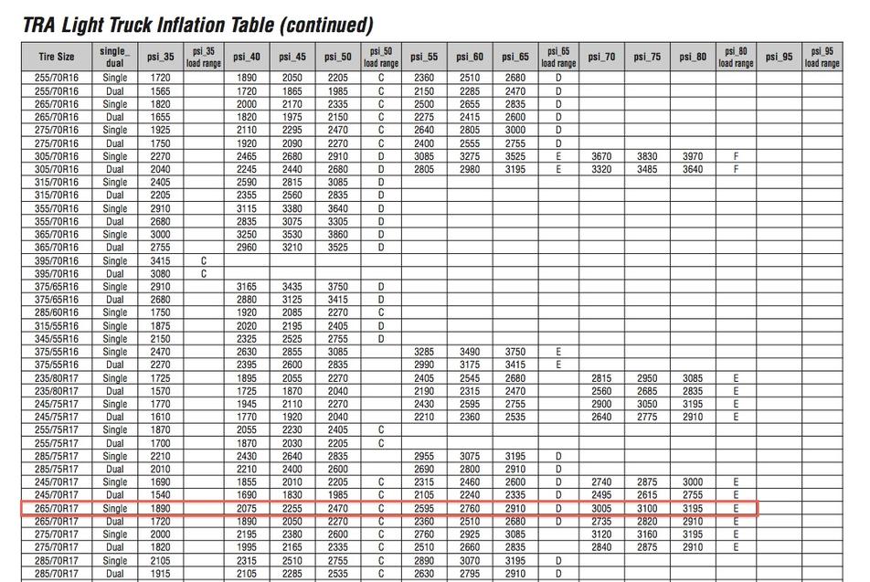

Got the tires, got them installed. Pics to follow! Now what pressure is everyone using? 44psi or something closer to stock? These are stock size LT.
On my stock size LT (E) I am currently running 40 psi. I was running 44 after much research, but every little bump was annoying as hell. 44 is probably close to optimal on a stock size E rated tire - meaning it preforms the best under lots of weight, but for every day driving I found 40 to be a bit less of a pain in the ass...literally. FWIW I did Toyota care about 7k after getting my tires switched and my millage dropped like a rock. I'm talking 14 mpg with nothing, but a smaller antenna. Turns out the dealer set them all around 32 psi. At first I could not figure out what the issue was because the stiffer sidewalls make the tires look almost the same at 32 psi as they do at 44 (my old Subaru will look 1\2 flat 10 psi down). Finally I just took my pressure and found the issue. Mess around with pressures and find what you like - just realize that tire pressure is give and take like anything else and there is no "optimal" pressure because conditions are always changing.
