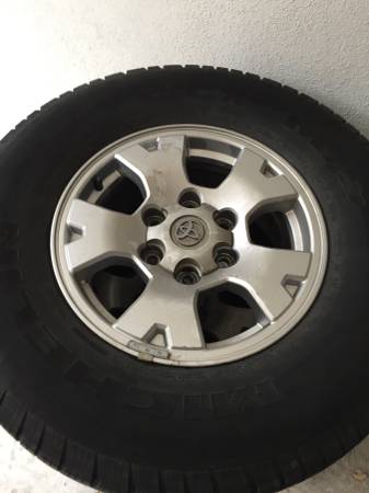

1st, Im sure this is out there on the internets somewhere but Im in a hell of a time crunch.
Need to get my Level8 MK6s and Duratracs off my runner since insurance is only offering a laughable $75 for 1800 worth of wheels and tires.
Thing is I need a set of toyota alloys to swap back on tonight/tomorrow and Im stuck at work scrambling to research.
would these stocko tacos fit on a 13 TE?
Highly unlikely as those wheels are 16", and the 4Runner requires as least a 17" wheel to clear the caliper and rotor. You're better off trying to find Tundra, FJC 17", Sequoia, GX470 or older 4th gen T4R wheels.
I put a set of fj wheels on mine. Also had a set on my 4th gen. I like the because they are a 1/2" wider and 1/2" more offset.
Might also consider expanding your search to include Chevy or GMC wheels. Easy to find in 17" and bigger and lots of 1/2 tons run the 139.7mm bolt pattern. Just watch the backspacing. Some are positive offset and may sit in too far on the runner without spacers.
