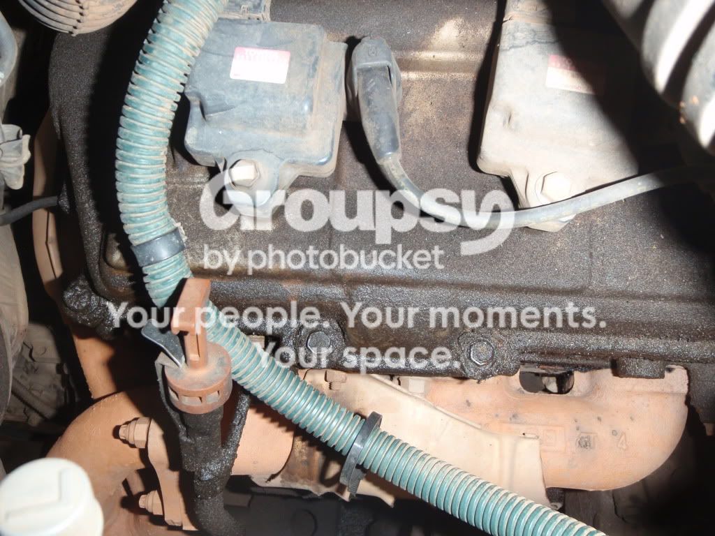

I've heard on the 3.4's the valve cover bolts can loosen over time, causing oil to leak out. So today I went out and tightened them, and all of them were super loose. Some so loose it took almost 6 turns on the wrench before they even began to tighten down. The FSM specifies to torque the valve cover bolts to 52 ft. lbs, I just tightened them down pretty snug by hand. As I was tightening down the bolt just below the oil fill, the valve cover cracked, completely isolating the bolted portion from the rest of the valve cover. As of now it hasn't leaked through the crack as far as I can tell, but I'm really determined to order my gasket kit soon and fix the crack before it becomes a big problem.
Crack is just to the right of the bolt, you can see it in the clean portion of the valve cover.
P8270322.jpg~original
Just a pic of how bad my valve covers leak.
P8270323.jpg~original

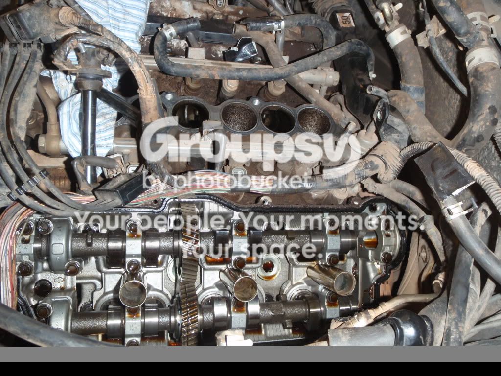

So over the last few days I've been tearing into the 4runner, I've replaced the leaky valve cover gaskets, old spark plugs as well as the leaky oil pan. I'm happy to say I am all caught up on my maintenance.
The valve cover gaskets wern't too hard to replace, just lots of steps and lots of hoses to keep track of.
I've never seen such clean valves during a valve cover change, usually there is at least a little carbon and sludge buildup, but there was absolutely zero on mine. Even after 240k miles, she looks like new.

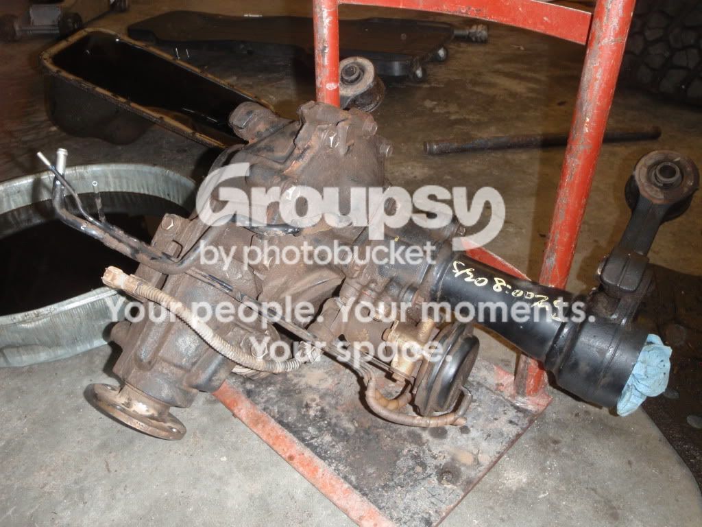

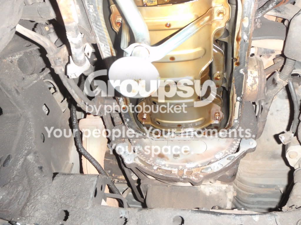

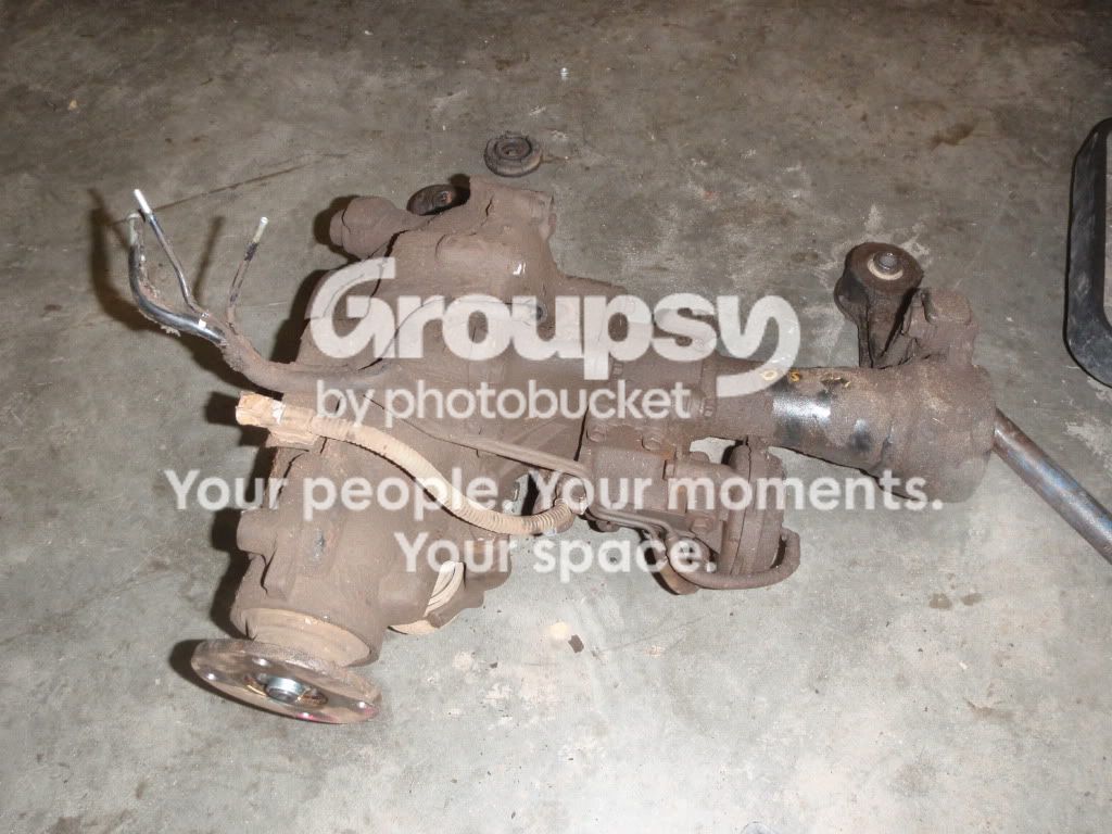

The oil pan replacement was not at all like the valve cover gaskets, it was a complete pain in the ass. Trying to wrestle that greasy front diff out was a nightmare, it took me over 3 hours.
Covered in a half inch of grease and grime
P9210455_zps58c3d4fe.jpg~original
Cleaned up a little
P9210458_zps9365d2fc.jpg~original
No gunk above the oil pan either
P9210461_zps244491be.jpg~original
I had the genius idea of replacing the gear oil in the diff before I mounted it back up, so I had to deal with over a quart of gear oil pouring all over my face while I mounted it back up, I'll have to fill it up all over again tomorrow. I'm just glad it's done!!
