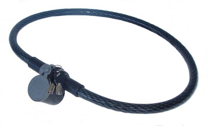

riverider -
how thick is that cable you have on there?? just from the looks of it in the attached pic - it doesn't appear that it would last very long here in downtown Chicago - but maybe its thicker then it appears.
Motivelock/winchlock - they used to have a big ass cable lock which had the same lock thats on the BlackMax - called the Universal Cable Lock - which lasted 1 week on my old Explorer and it was cut thru like butter one evening.
I still have one of these cables as I use it for locking up my bike around chicago - its freakin heavy as hell and alot thicker then any bike cable I have ever seen. But proven no match for tire thieves.

riverider -
Well looks don't always tell the full story. It's aircraft quality cable, and if you have ever tried cutting them you find they are malleable making the cutting tool slip as the strands keep moving away from the cut. I sold them to the motorcycle bunch for over ten years, and never had anyone tell me that my cable got removed.
If someone has the time with today's battery powered tool's they can cut through any cable lock or chain. But it takes time and most worthless thieving rats just don't want to commit to this much work.
