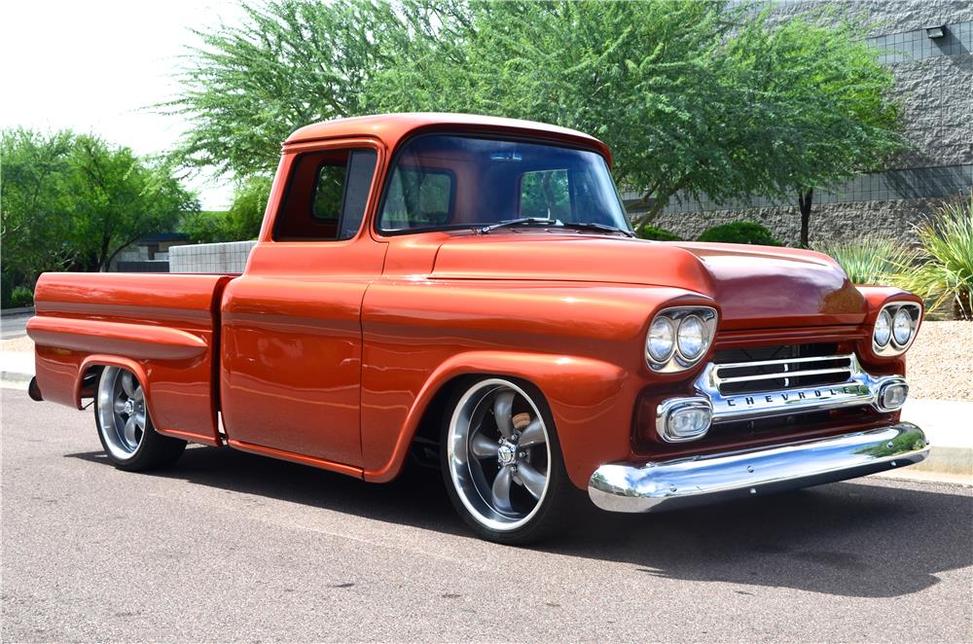

I love Bunrt Orange but two tone always looks nice on vintage trucks.

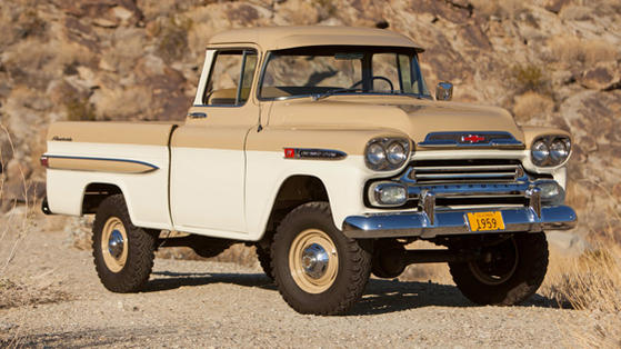

They look good either way. Lowered a little with a stepside short bed or lifted 4x4 Fleetside. I'd go for the stepside hot rot look with a posi since I already have a 4x4.
