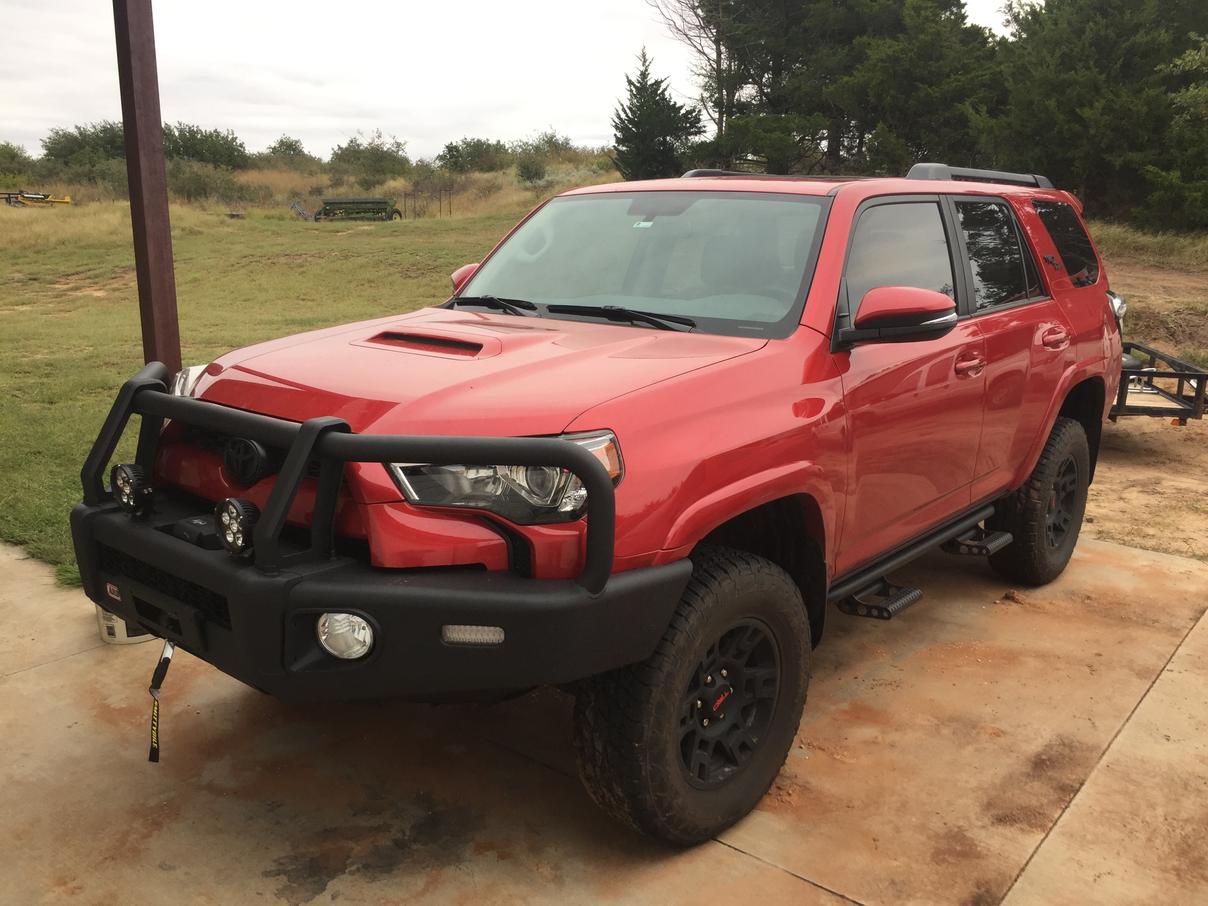

Eiback Pro Truck lift, best bang for the bucks and front is adjustable for height.
Awesome! Looks great. Is that anything I can use with KDSS?
Also, any idea how tall your truck sits altogether?
you can pretty much use any lift kit with KDSS for the most part.
Where you run into problems are with shocks that have remote resi's, they will require a different mounting bracket for the remote reservoirs.
So as long as you are shopping for a standard spring and shock/coilover combo, you will be fine.
