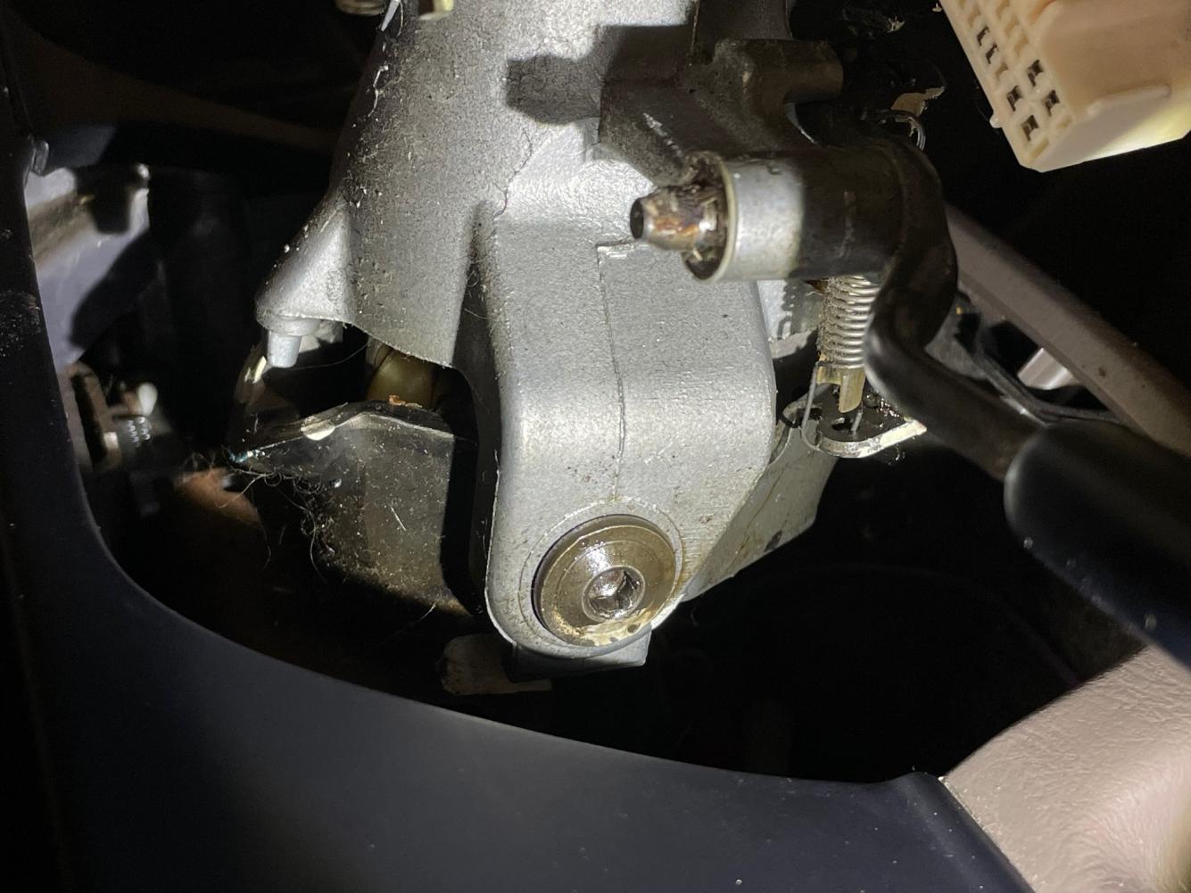

Trying to fix my sloppy steering. Has about 1" of play both ways and isn't responsive especially at highway speeds. Replaced steering rack bushings so I think I need to weld the shaft and fix that plastic ball. However when attempting to remove the steering rack I just can't get a grip on this last bolt to remove it. The allen wrench just spins after a bit of force and the next size up won't fit. Do I have any options to remove this? I am a bit limited to basic tools so I think I am out of luck...

Grind down the over size Allen key gradually while testing it for a snug fit making sure not to destort the shape of the allen wrench or use the same grinder and carefully cut a deep enough slit and use a big flat screw driver.
Torx bit does the trick sometimes. Could also try going up one size in standard sizing, assuming it's metric. Might need tapped in with a hammer to work
Allen head extractors are worth their weight in gold too
Those things are pretty hard to snap loose from memory. Best to find a bit that fits it very snugly to avoid the slipping.
Get a good quality sharp chisel for metal 1/4" to 1/2" wide.
Use the chisel at a 90 degree angle on the edge of the bolt head and give it a good hit with a hammer.
That will put a nice groove in the edge of the bolt head.
Then hold the chisel in that groove at a 45 degree angle and hit the chisel with the hammer and and turn the bolt out.
