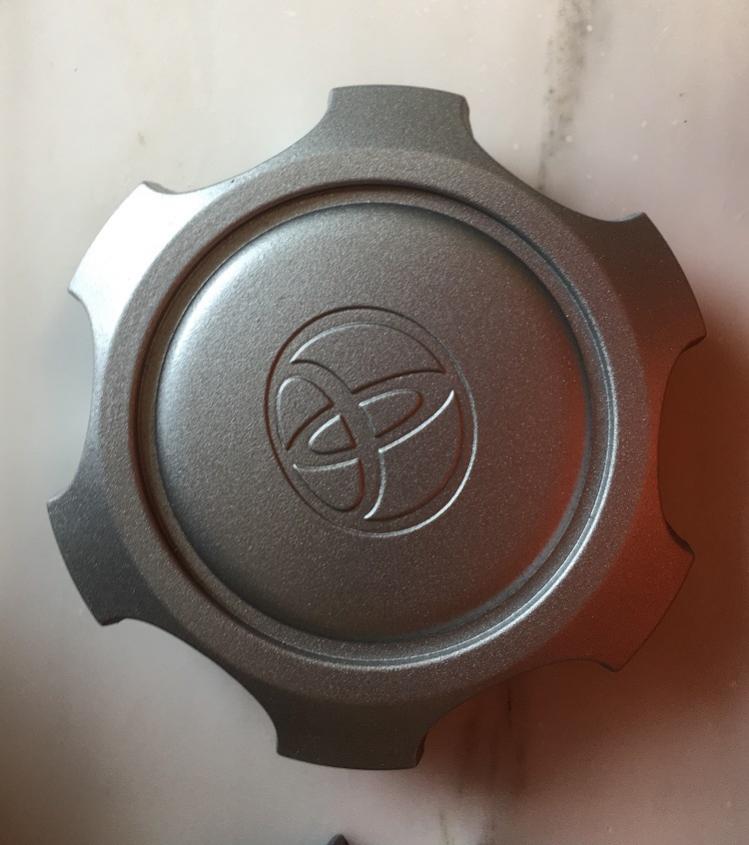

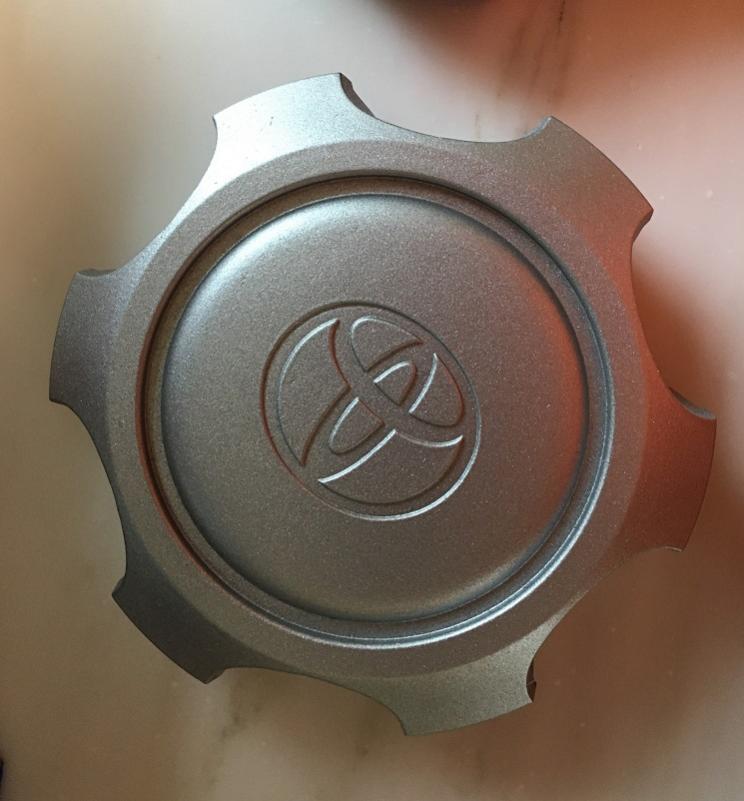

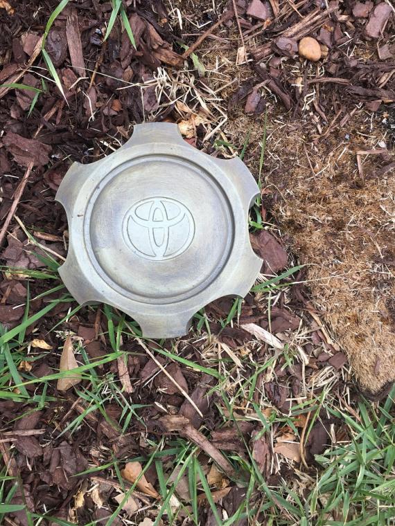

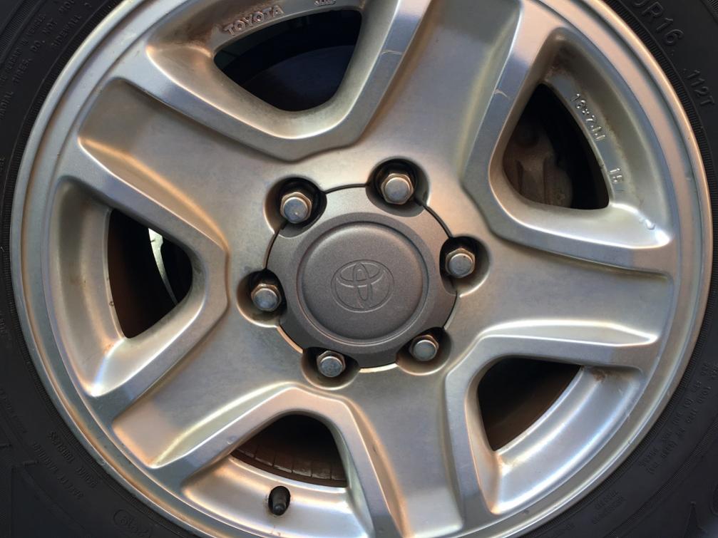

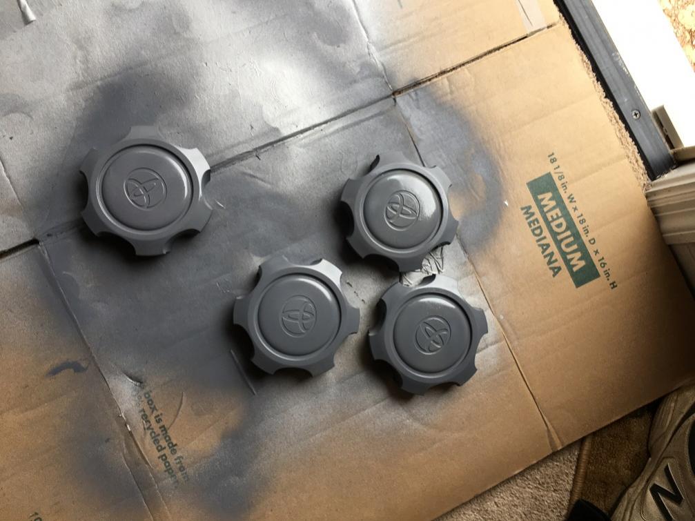

I went total OCD on this simple job. Obtained five center caps from junkyard. First stripped with acetone and steel brush. they are plastic at that point
Hit them with Rustoleum 2X Primer and then duplicolor silver wheel paint. Went OCD and did this three times. The first time I had too much silver, the second time the silver peeled back after drying. More acetone and start over. The third time I sanded with 0000 steel wool before primer and buffed silver paint after it dried and applied two more coats. This silver seems to have a little "sparkle" in it and I am not OCD enough to hand paint the logo.
The real issue is that I am probably going to take the worst looking of the five and paint it black to see if I like that better - in which case I may do this all again

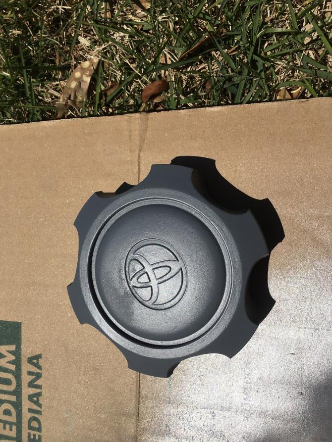

Testors paint stunk. Looked like a 10 year old did it. Also I decided I did not like silver so I found a few more caps in junkyard and did them in Duplicolor Graphite. This looked a lot better
