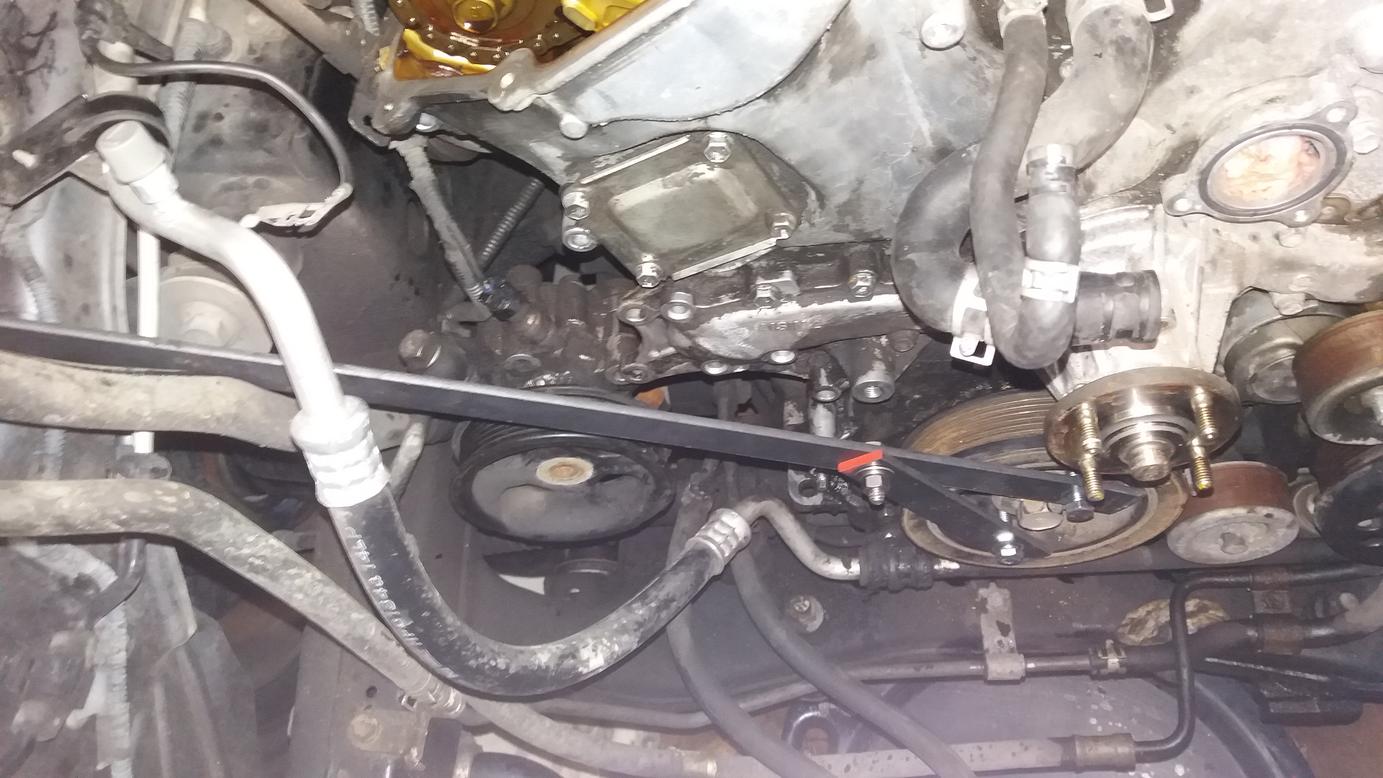

I've tried the starter method with a breaker bar. I built a tool that uses both bolts but no good. I used map gas on the bolt. I guess I'll have to get the Schley tool or find a big ass air impact to rent. I love spending extra 2 days to remove one bolt.
Good news is the timing marks are all perfectly in line at 160k miles so no chain stretch.

Breaker bar and jack? How do you prevent the crank from spinning? I'm going to try a strap right now before I go rent a big air gun.
I used the same sort of crank pulley holder that you have. I just stuck a pipe on the end of it, removed the air intake that sits on top of the passenger fender and stacked up some wood blocks on top of the fender for the pipe to press against.

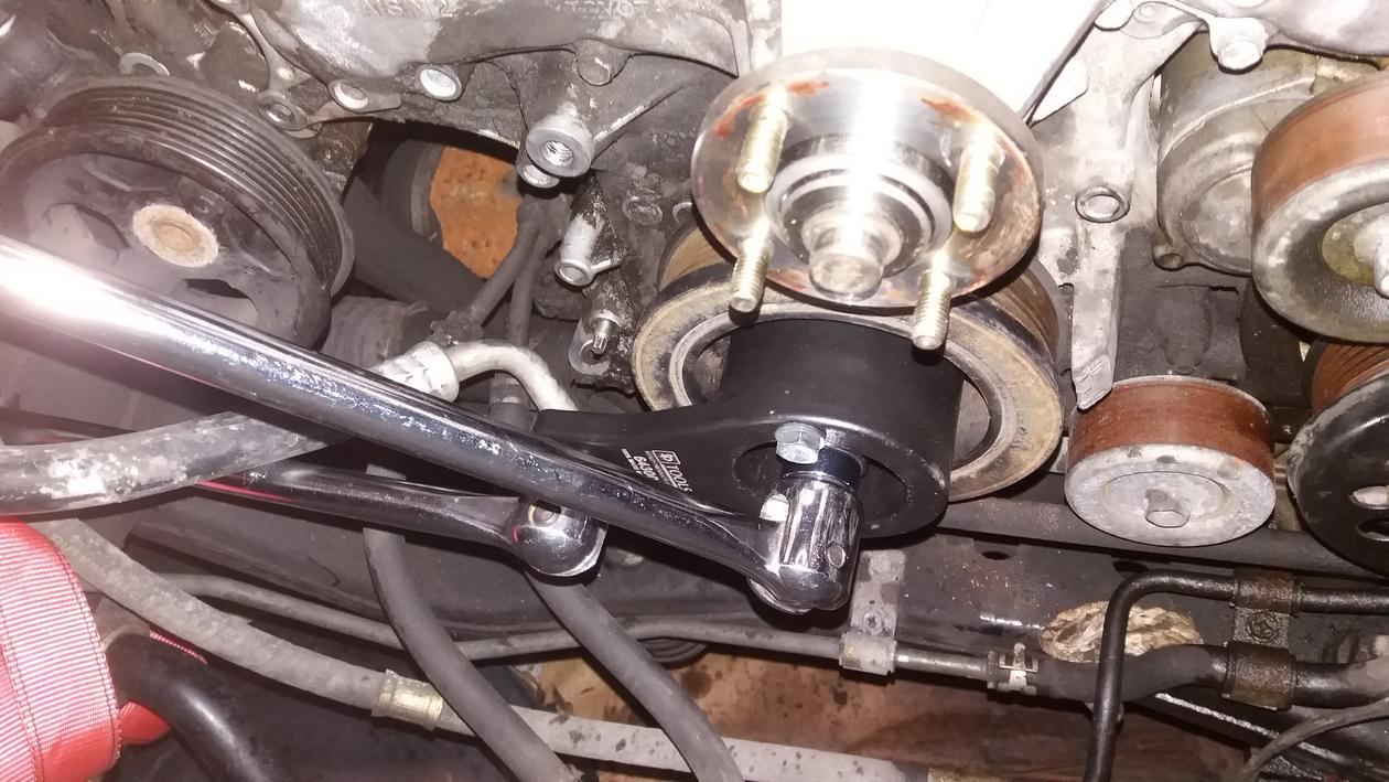

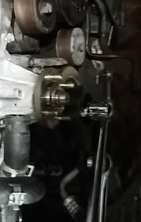

The correct tool worked amazingly. 3 minutes to align the tool and get a bar in. One tug with the other bar.
