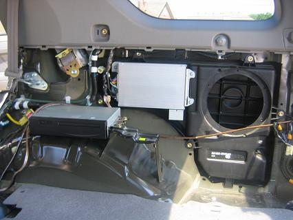

Sub and Amp install (PICS) '03 T4R
The little tab that sticks up on the top left side goes into a factory mounting location. I'm going to use that to hold the box in place

After the last layer was dry I put it back in the 4Runner so I could mark where to trim it. I decided not to use the bottom portion cause it just didn't work out so I just cut it off.
The mounting tab that I added in may not work as planned. After I get the rest of it finished I'll see how well it will work. My concern is that the cargo cover may not lock into place with how thick the tab is. I may just use a peice of thin guage steel and secure it to the back of the box with some screws.
After marking my trim lines I pulled it back out and used my Dremmel to trim it. After about half of the trimming was done my Dremmel got so hot it started burning my hands. So I switched over to my 3" air powered cut-off wheel and went to town.:biggrin2: That made short work of the rest of it. I then used my angle grinder (With flap sanding disks) to make the mounting tab a little thinner.
