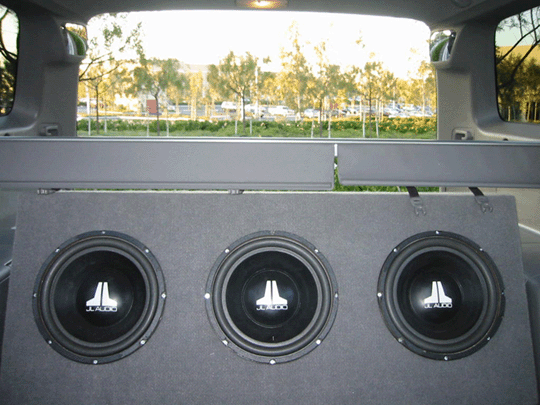

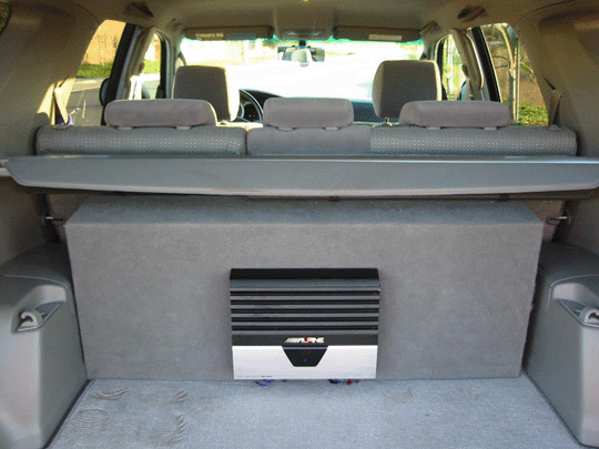

I built my own enclosure and wired it up myself:)
Minus the sub enclosure...It took me about 6 hours. What takes long is finding out where all the tabs are in the panels that you have to pull off. Now I know the car inside and out and I can do it much quicker.
