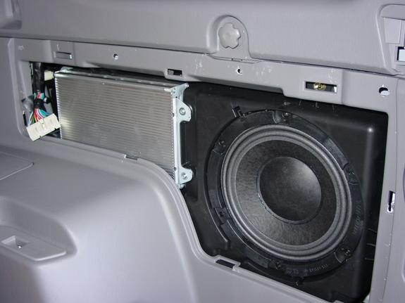

If you mute the center speaker, it's a lot less loud. I was thinking of swapping the factory speakers too, but I'm just going to wait and do things the right way -- by adding kickpanels or a waveguide, so the music will be more centered with proper staging. Here's a picture of where I'm going to have the custom enclosure built. It's going to be a fiberglass a-periodic enlosure from one of the most reputable car audio shops in the US. (http://www.usdaudio.com).
Hey, that's the picture I took of my 4runner's stock sub & amp for CarDomain. I guess people found it useful. Notice the amateur scratches as I removed the panel. I also have a sub & amp installed using the high-level from the stock sub. It's good enough for now until I save up for a more complete install.
Here are a few more pics:
does that smaller cover panel come off without taking the whole interior panel off first? Is there an easy way...Of course without tearing it all up.
I've tried a couple of times and it seems like its on there good....
The panel is on there pretty good, which I found out the hard way. There is a thread here somewhere that shows in detail how to remove the entire panel - can't remember who, but it's a better way to go.
I took off the entire panel and noticed the clips were permanently fastened for the smaller panel that goes over the sub....I'm not sure how people have removed it in the first place....anyway, removing the whole panel only took about 15 min.
