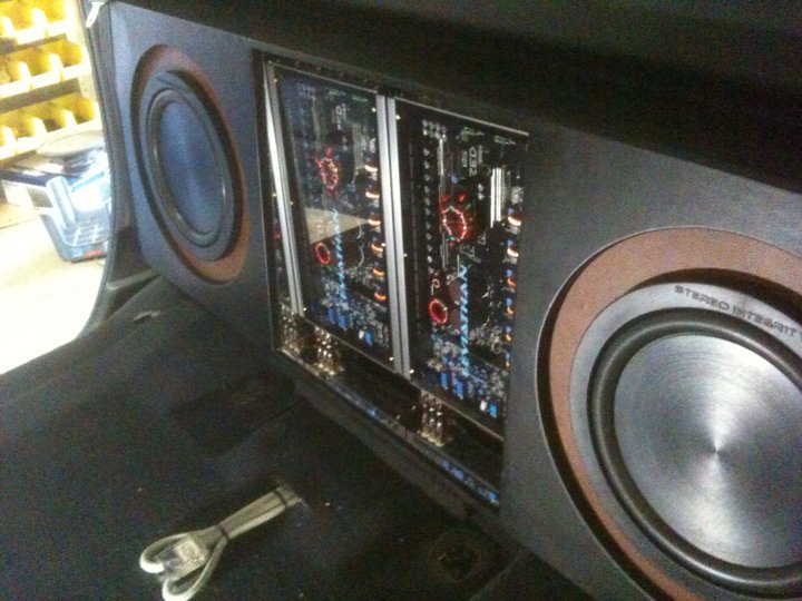

I put 2 12's behind the back seat on one of those Tundras let me see if I can dig up a picture of it.
How do you like those SI subs?
Im impressed by the amount of room behind the seats of a Crewmax. But Im sure if the OP had a Crewmax, he probably wouldnt need to put subs in the floor.
