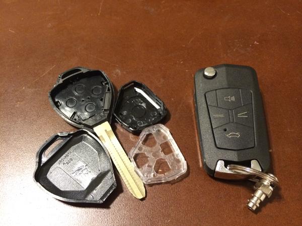

Now I took this swap a step further. I purchased a flip key too from globalkeyservice.
The flip key has a plastic cradle inside to hold the fob inside the flip key case. I had to take the fob out of its case within the key to make it fit inside the cradle. I had a Chip for the Key left over from my last flip key and glued it at the top near the flip key.
I used some thin foam to help keep the fob and case buttons engaged. You can also see the fob case portions that didn't fit in the flip case.

you mentioned you had to get the correct ones? what was the part number? also the link for the flip key that is the one you purchased correct?
Maybe I'm missing something, but if the FCCID for your original key is different than the flip one, how did you get this to work?
looks a though he just swapped out the guts from the key that has the same FCCID.
You got it! I bought a key with the same FCCID that match my original fob, and then took the internals out and put it in the shell of this flip key.
If you have a 5th Gen with a key with only three buttons, search ebay for a flip key with only three buttons.

does the key open perfect? like when you hit the button it flips right away or do you have to help it?
No problem with the key opening prior to opening the shell. After I opened up the shell, it took me awhile to get the spring pressure set back to where it was, but it springs out without an issue.
Here's an update:
The Fob is still working 100%! No dead battery issues with this one. I did switch back to the All-in-One key and am not using the flip key. Nothing was wrong with the flip key - if you want it, I'll sell it to you. The key hasn't been cut yet.
My reasoning is that I couldn't feel where the buttons were if I wanted to lock/unlock the car while the key was still in my pocket. The OEM fob and this All-in-One key has recessed buttons and a dot on one of them to help with that. I like that if my hands are full, I can find the button by touch while they're still in my pocket.:D
