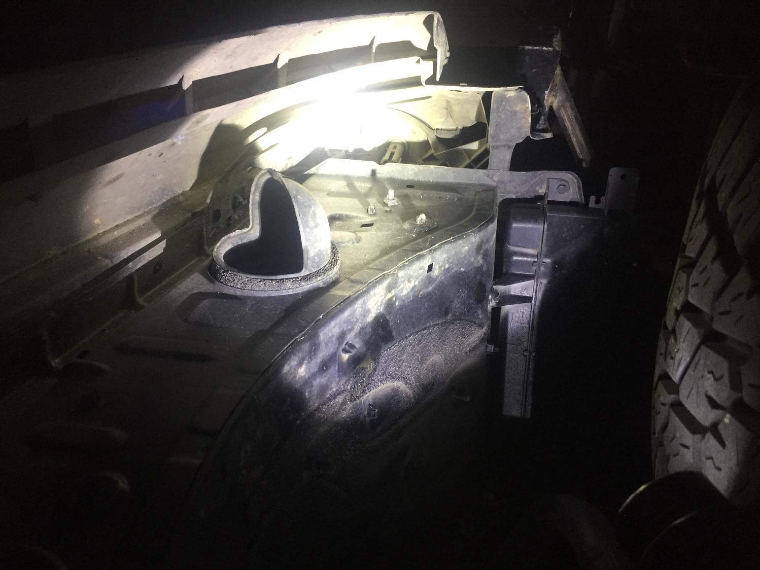

Must be deep because i dont have fender liners and ive been poor weather driving and for sure was going to get water sucked up the intake after hitting puddles got home checked the filter and was perfectly dry
It was pretty deep My fender liners are cut way up when I put my demello bumper on and it may have been enough to suck up some. Looking at snorkels I guess. Have never had this problem before. I believe it was just a good combo of speed that pushed it far enough up into my fender liner to get sucked in. Thanks for the replies guys.
