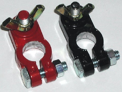

...There is a clamp type connection
Like this one? EWWW! :)
Marine battery terminal like this is better:
Thanks for all your ideas. I replaced the ends on both terminal cables Christmas Eve. Neither seemed loose or damaged, but the copper was fairly green. I cleaned all that up, but stuck with the same type of connector. The marine connectors would require crimping lugs onto the cables and I don't have lugs for that size. I think the marine variant is designed as it is to allow quick connection and removal of the battery for a trolling motor scenario, rather than an electrical conductivity advantage. That's just just me speculating though...not an expert.
