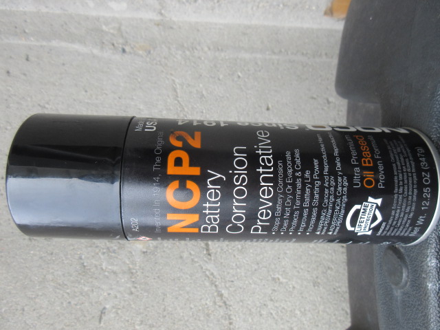

I like spraying this stuff on my corrosion prone connections, battery, starter, alt. Works good. Get this at Autozone.
I use dielectric grease myself.
Sent from my SM-J337V using Tapatalk
For plugs and connectors, sure. But for battery terminals and ground points, good old Vaseline is a conductor and works great. Dielectric does not conduct electricity. I keep both on my lube shelf.
Yes lots of folks use vasoline.:)
The only drawbacks to it is it swells rubber and is flammable.
