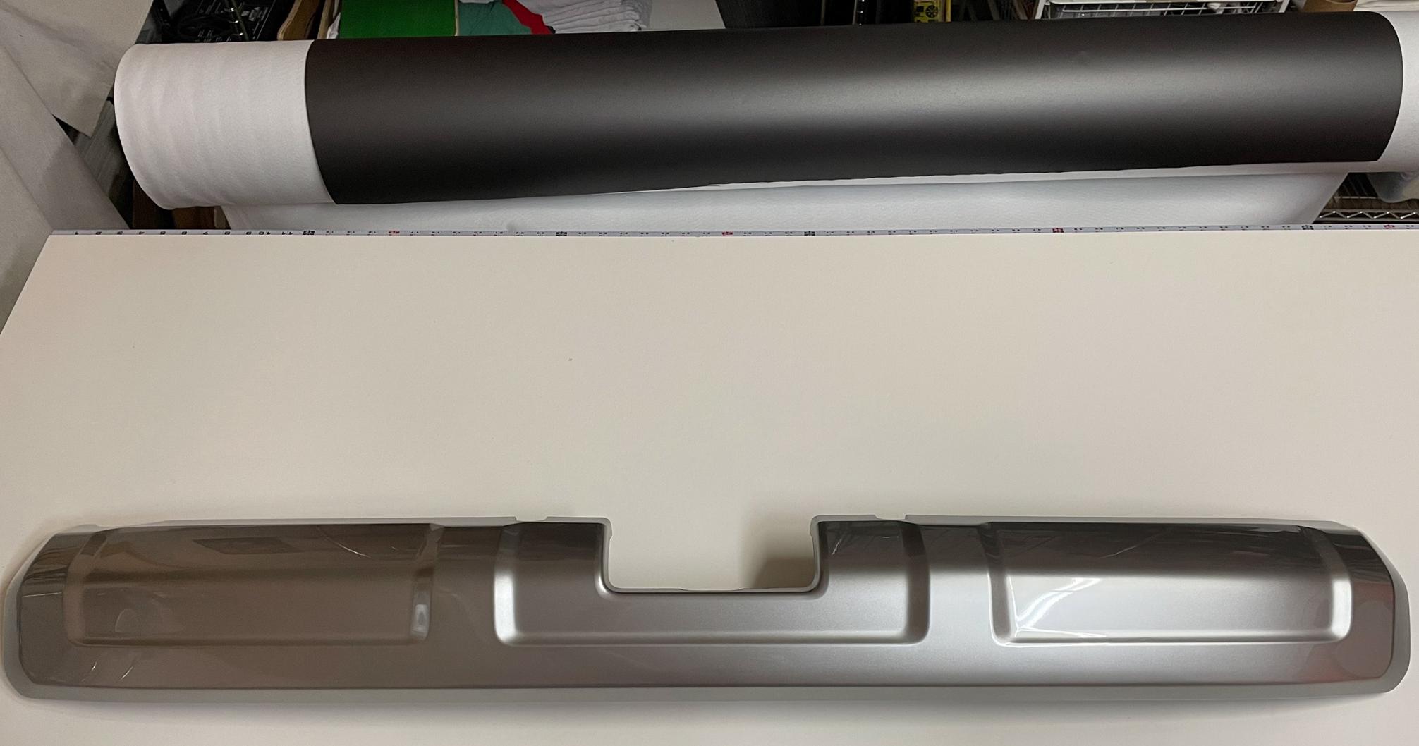

Grabbed the vinyl wrap I wanted to use on the front+back valances, it's darker than the picture shows, hoping it was darker than it looks on the roll tho; will have to see how they when I finish wrapping + reinstall.

my experience with magnetic metallic color vinyl is once its stretched out and applied itll lighten up. so i'm figuring black will do the same?

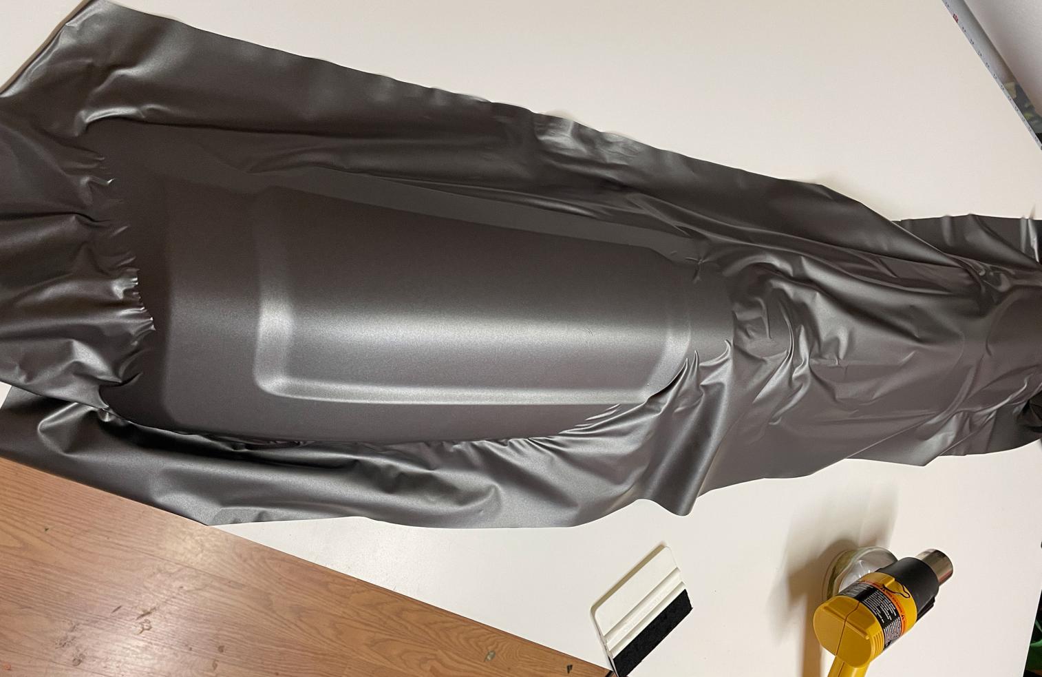

Rear Valence Wrap
Stoked, like it way better than I thought I would.

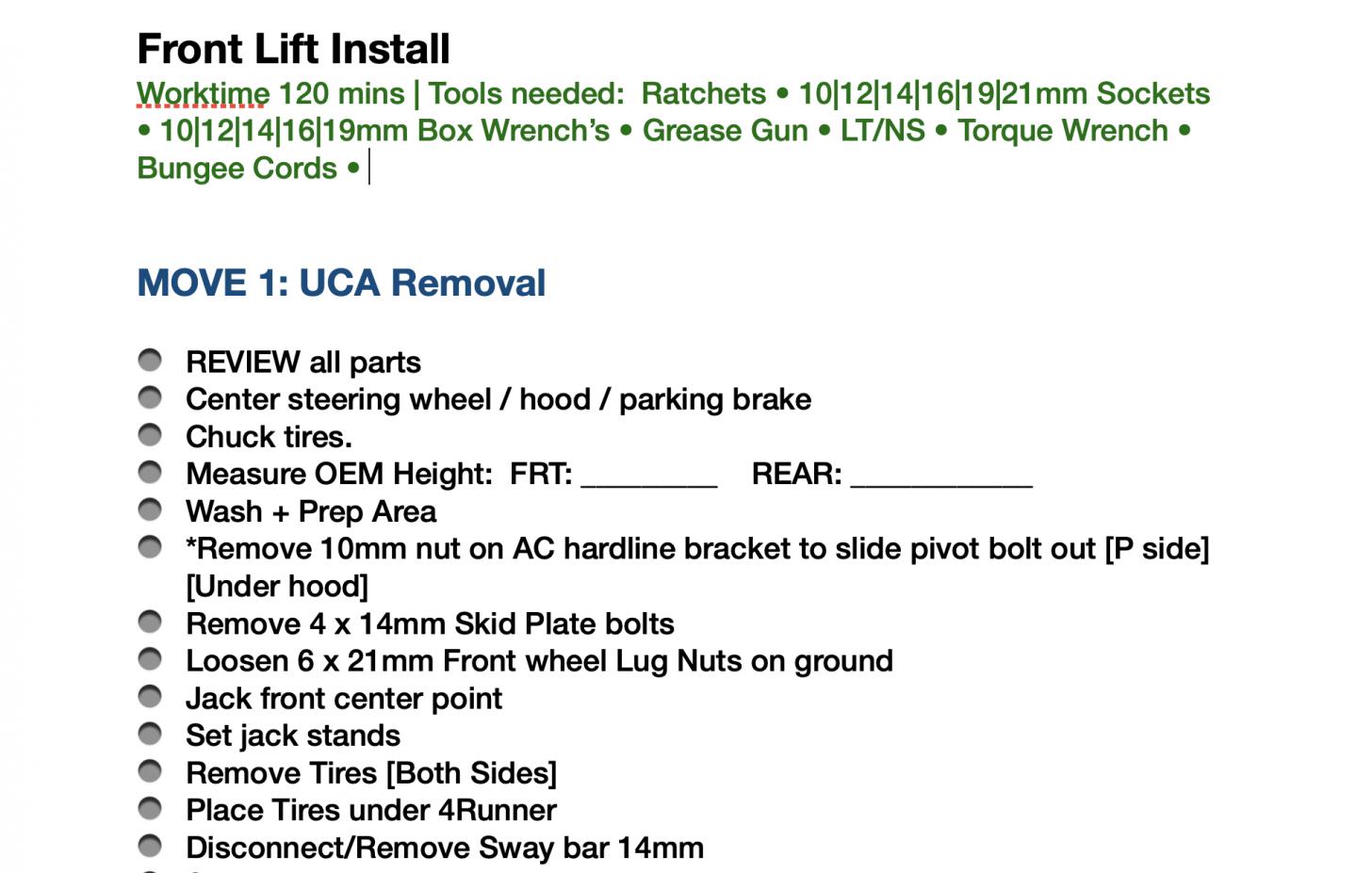

The install was much easier than I expected. I create install plans for most everything I do, for later reference, to make it easier to replicate, streamline workflow; that kinda thing. It's set up for the Toytec/JBA setup, but can be tweaked for any install really. I can share the lift installation chapters if you would like to use it for your install. I'll attach a screenshot
If you can that would be great since Ill be doing the install on my own. Thank you!
