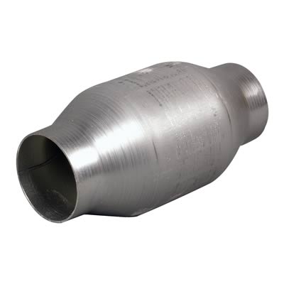

To be clear, that is a 'universal' type cat and needs to be welded in to the existing pipe. It looks like this:
You can also get a 'direct fit' type that simply bolts in and includes the pipe with the (front) sensor port. The rear one is on the leading muffler pipe.
