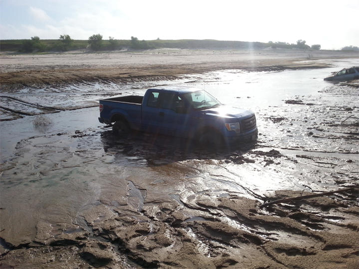

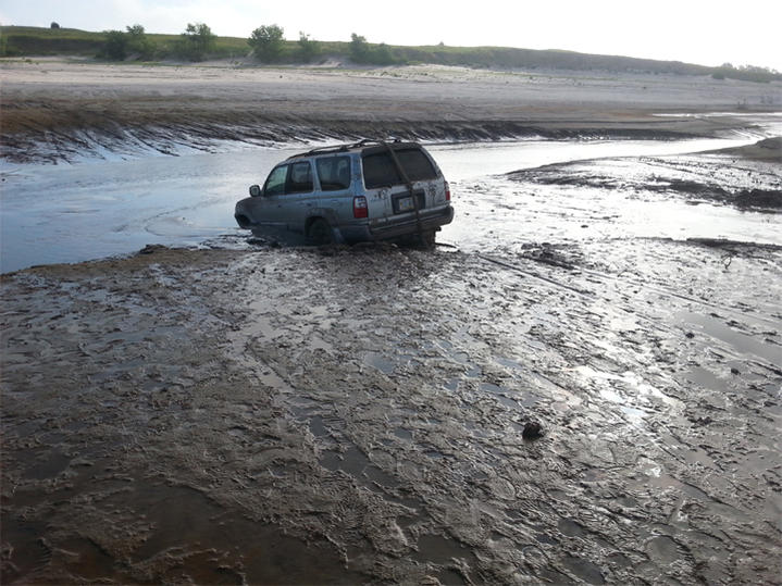

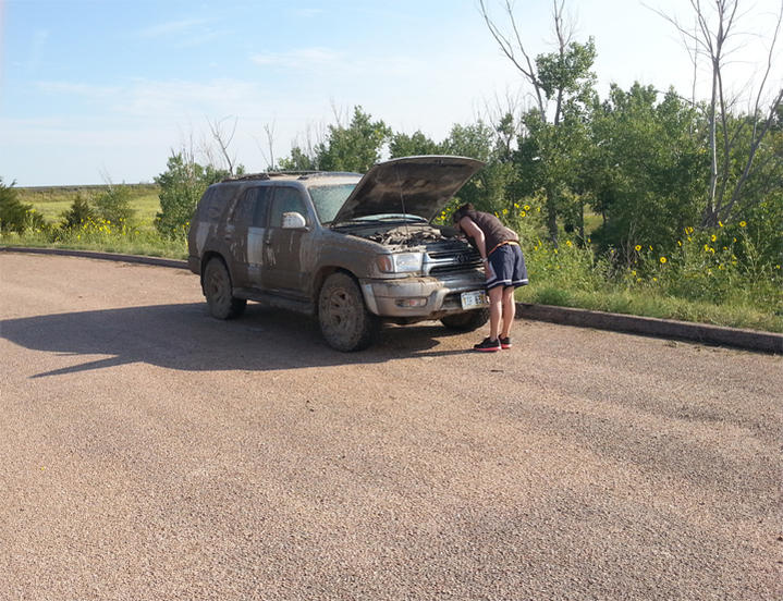

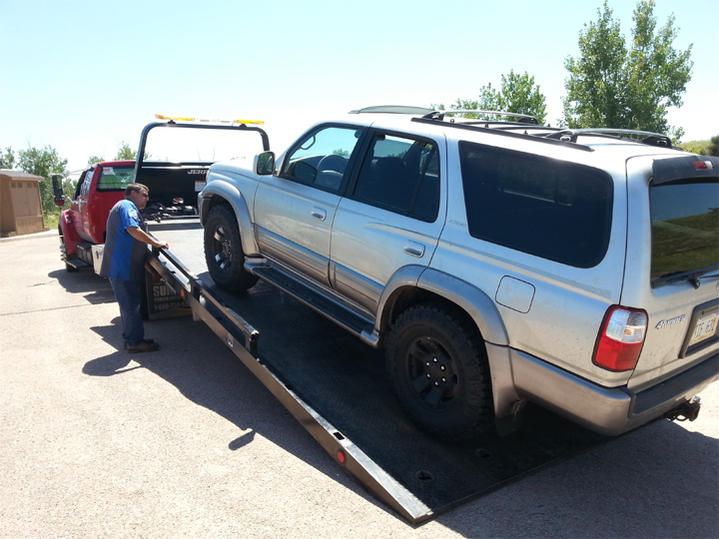

I don't know if this is as bad as ARKRAWLR's post. Roached the '01 I bought 2 weeks ago. Went to Kenosha pass with no problems. Drove through a river or two with no issues. Scangauge had the tranny temp at 231 at it's highest reading going up and down 285 and everything was running fine. On the second leg of the trip at Lake Mcconaughy I screwed up bad. Went out playing with my buddy and his F-150 and went through what seemed to be an innocent mud pit that we've done a thousand times in the past. Turned out that it was not a receding pool of goop, there's actually a spring that ran underneath. He blasted through and broke it up. I followed and was not so fortunate. Sunk it and stuck. Got my other buddy over there with his '06 Taco to try and pull it out. Originally had the exhaust under water. Managed to get that above water at least. At that point the Runner was more cockeyed and my feet were under water at the pedals. Had about 4-5" of water in the cab on that side. The next morning we got a tractor to pull us both out. $60 each. Pretty reasonable for the idiot price that I felt. Started it and thank god I didn't get water in the motor. The second I pressed the brake to put it in gear it died. Alternator shot. Sat under water in the muddy stream all night and filled it with poo. 350 miles from home got Napa in Ogalalla to order one from Denver. Got it and installed it the next day. Fixed my voltage issues then tried to drive it to the RV dump place that has a hose. Had no speedo on the dash or Scangauge. VSC lights on, ABS lights and tranny running like poo. Finally the SG gave a code of P0500. Got under there and cleared the mud and goop above the tranny and wiggled the connection on the VSS and that fixed many things (other than the mud and goo inside the truck on the drivers front and rear side). At least it was moving. Took it down to town the next morning to the power washer and got all the pieces and parts sprayed out. It seemed to behave better after driving a bit after the Alternator and the VSS were tended to. It was running a little hotter than normal but the transfer case and center diff lock and electric systems all were happy. Pulled the kicker panel off to see if the 4WD comp had sat under water and also to help all that wiring to dry out. The water line was just under the comp. Drove to town the next morning with the wife and on the way back it got fairly warm. Dash coolant gauge got just under the red. Tranny got to 244 at highest point. Pulled into the park and stopped at the ranger station and the Runner died at idle. Started it and it fired right up. Put it in gear and died. Tried again, threw in reverse and got it backed up and off the road. Had friends pick us up and take us back to camp. Went back after it had cooled off. Figured out I still had a bunch of sand and muck clogging the back of the radiator. However, the tranny was still very angry. The only way to get it moving was put it in neutral, get the RPM's to 1000-1500 and release the brake. Got back to the RV hose and cleaned the rad. Limped it back to the parking lot above the campsite. Scanguage showing a P0770 code. Tranny shifter solenoid. Harnesses and input were clean and tight. At this point the tranny clearly had some noises that were definitly not right. Thank god I had gear with me, good friends and computer phones. Still not enough to be dropping tranny pans in a parking lot full of sand 350 miles from home. Called it done. Made some calls to Omaha and I'm getting it towed back for $400. We're hoping it's the torque converter and I didn't roach the tranny. Just wanted to share my story and see what ya'll had to say. Call me an idiot but I've learned some valuable lessons. Either way I didn't let it ruin my vacation and everyone got home safely. At least I gots my '96 here. I can't help but feel the '96 would have had better chance to make it through the pit of doom. Again, I always appreciate everyone's help and advice.

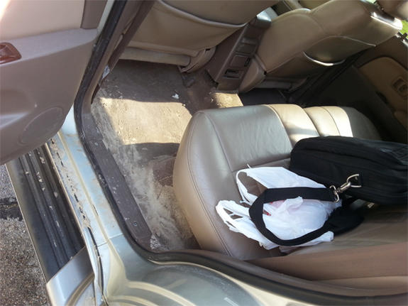

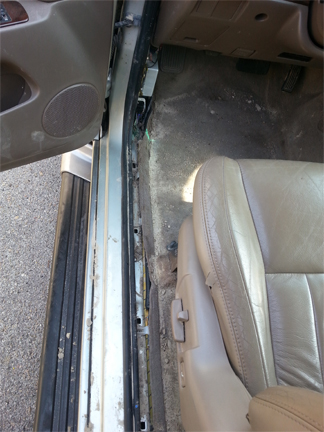

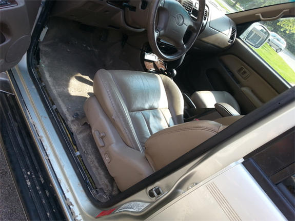

any interior pics?
I live right outside omaha and i decided awhile ago im just going to stay away from mud. Around here it seems to be either puddles or huge sticky messes where everyone involved gets stuck. Including a 2003 ford focus my idiot friend destroyed lol
Here ya go. It's a lot worse in there than the pics portray. Started the process of cleaning it out this morning (after the pics). If you're ever in town, stop by my shop. I'm on 90th & L.
