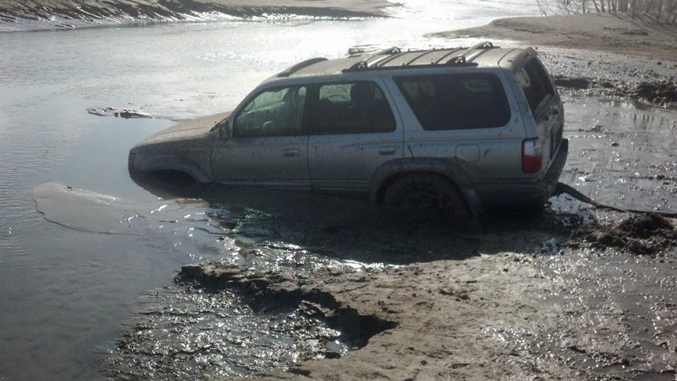

Carpet and door panels are getting pulled soon. I also have a new rad to to install. I've been in and around many people stuck in the past but this was something different. Here's a new pic my friend posted. Don't do this.

Damn, man - Gotta ask how it got that way and that the outcome was.
So I'm going too go out on a limb here and say it had something to do with that beer can set down next to the headlight.
To be fair though (in case it didn't), if I had just wrecked my truck I would definitely have a brewsky.

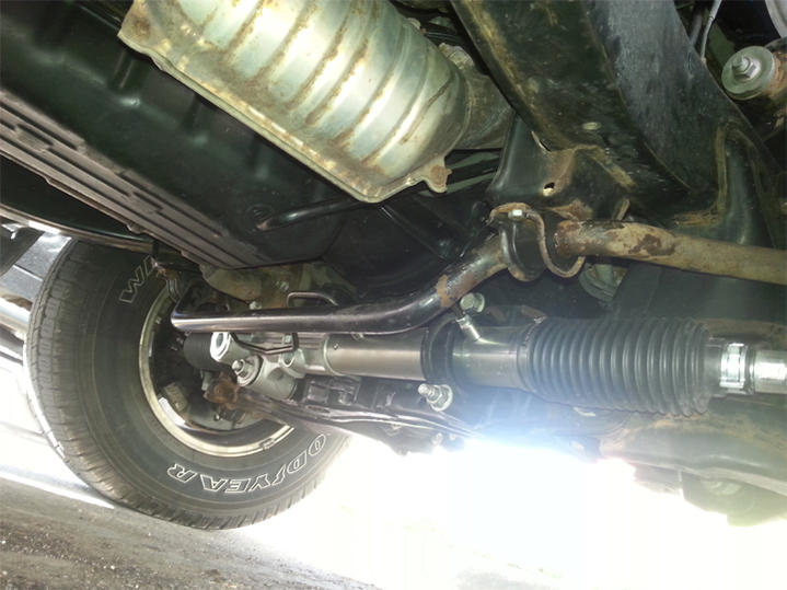

Update 9-17-13 -Holy poop, almost done as far as I know. Biggest concern is the wiring harnesses that were under water. All the electrical systems are operating as they should. Got a starter from a junkyard in Denver and replaced the contacts (they weren't bad but just to be sure). No fun to replace starter. Gonna rebuild the other one for a spare. I pulled the interior completely which wasn't that bad surprisingly. No mold or badness. Let everything dry and shampoo'd the carpet with my old lady's steam cleaner. Disco'ed the harnesses from the 4WD comp and main underneath it (they had no sign of corrosion) and sprayed contact cleaner and dialectric greased 'em. Everything's re-assembled, did the Tundra 13WL's yesterday. All I need to do is figure out how bad the steering issue is. It was a little loose when I bought it, I'm pretty sure what I did didn't help. I know I need to do the rack bushings (has a solid inch of play). Might need inner tie-rod on the passenger side. Don't know the condition of the internal parts of the rack. LBJ on the passenger side is gooing a little bit but still tight. Don't want to spend anymore than necessary. I'd like to think I can do the rack bushings, guide and LBJ's and call it good. Fairly cheap other than the Ball Joints. Can't cut corners on this. I refuse to turn it over to the Mrs. until everythings' solid and safe. Any thoughts?

On a lighter note, found out yesterday I gotta replace the steering rack. Yay. Least I got the Tundra brakes done on Monday so that's nice -

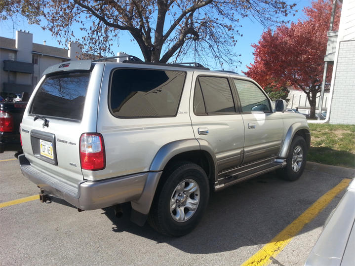

I'm done. 3 months and a lot of money and work later, finally done. The wife is so happy = me happy. I screwed up big time. At least she was with me when I did it. I've learned some valuable lessons and also how to rebuild a late 3rd gen Runner (aside from upgrading my '96). Thank Buddha for my good buddy and my brother for helping me. BRIANSD, I did OEM replacements other than the rack. Hooray - Happy 4Runners

impressed. is it better than it was in every way?
Yes. Especially the brakes and steering. Everything's running great as far as the wife says. Next year, I'm gonna do the TB/WP and slap a new rad in it that I have laying around. Might steal the heated seats out of it and retro them into my '96. Don't think she'd be too happy with me, though. Still need to disable DRLs and get some LEDs in the interior.

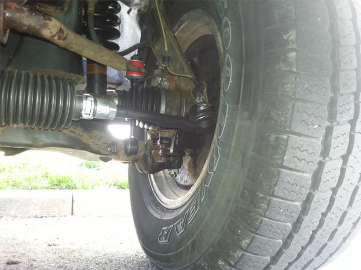

So which steering rack did you go with, and what do you think of it?
Used the AAE rack from Rockauto and poly bushings from Wheelers Off-Road. The rack seems fine, especially for 1/2 the price as the Safari one. The only issue we ran into was my buddy assumed the pinion was centered prior to install. It wasn't. Luckily we didn't have to completely drop the rack to re-center it. The rack came with a 2yr warranty as well.
