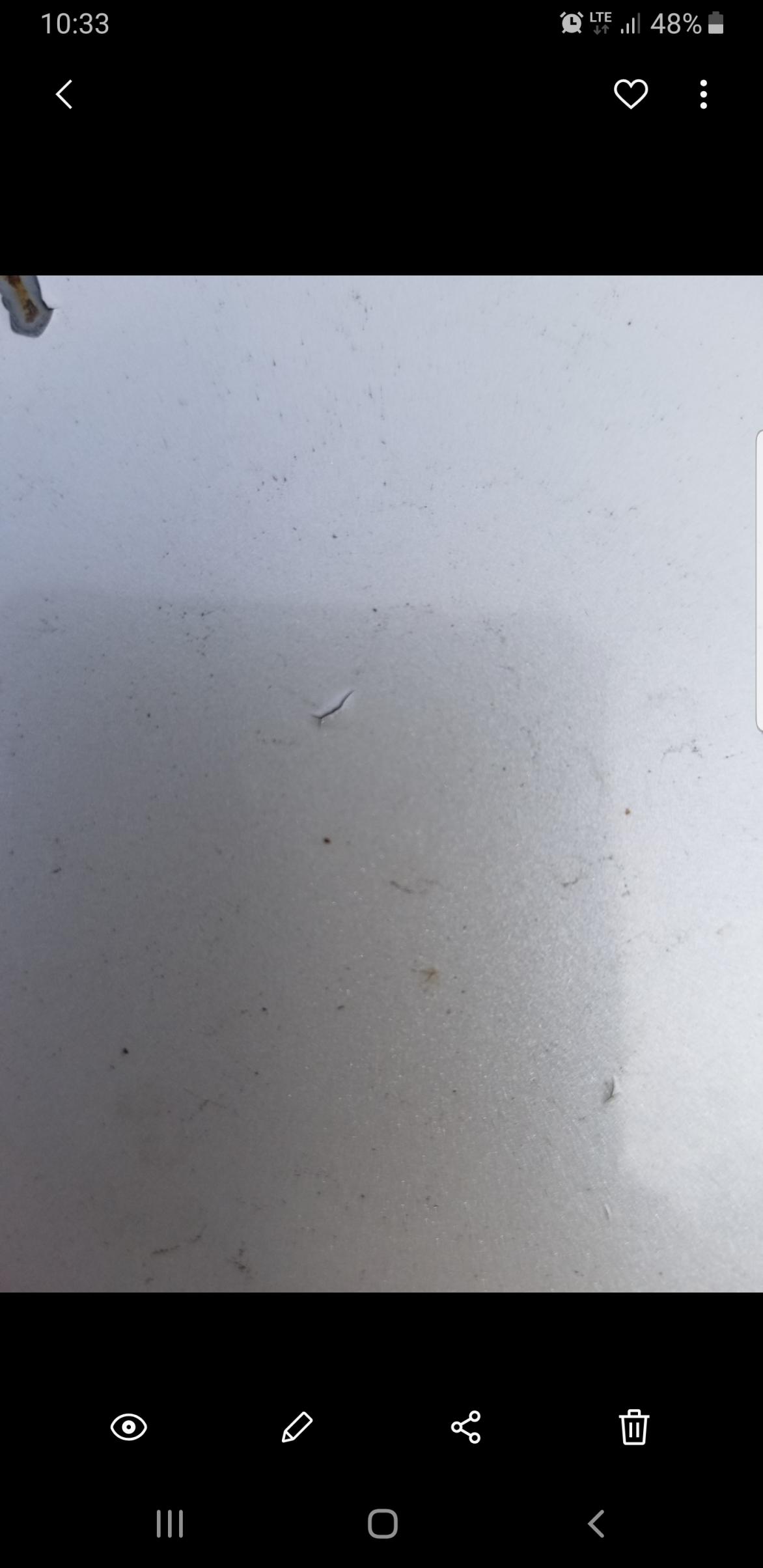

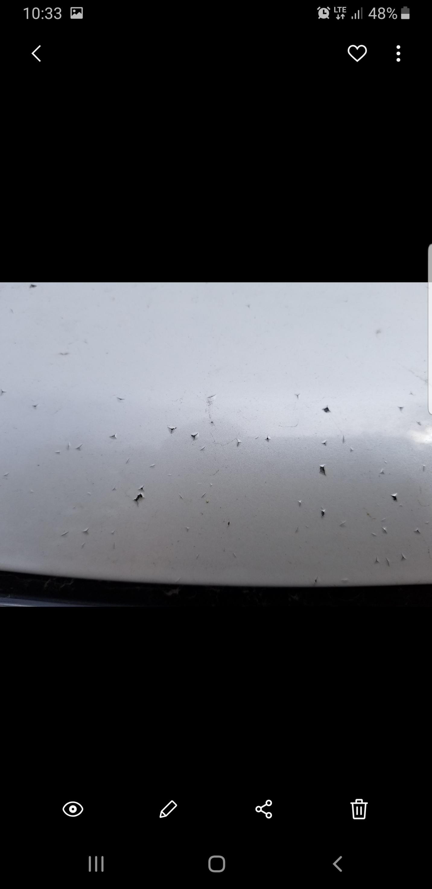

Yeah as you can see it splits open on my hood. I imagine its thinner here and gets beat by the sun more. Obviously some are chips but a rock chip doesnt cause the slit seperation areas. My hood is riddled with them.

That doesn't look good! I think you should be first in line for a re-paint on that one. That's definitely an issue with a failed chemical bond to the primer underneath, not a rock chip problem. Bummer to see it on a 4R. That's the first I've ever heard/seen of it on a 4R.
Yeah, hopefully Toyota will take care of it for you. The way it seems to be flaking looks like it isn't just from rock chips. This is one of the first pics I've seen of the SW paint failing on a 4runner. Thanks for sharing.
Likely a failure of pretreatment or metal prep. Probably not the paint itself which has failed. Delamination of such large sections is a colossal failure. This doesnt appear to be corrosion and or filiform type corrosion due to the sheeting delamination. Base prep was off somewhere.
I'd agree
