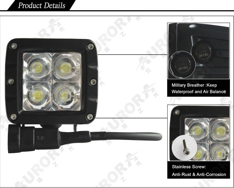

Aurora (make sure the are the IP69k, as i noticed even a copy of this. They wouldnt gove me other specs such as ip rating, i noticed it was a copy because it wasnt ip69k and there was no german waterproof connector only pigtails.)

Right, the Aurora is not exactly the same optics that is the difference. Though I believe there has been lawsuits since they use the same parts and made the optics similar. Ie the lens. Using a ge lexan optically clear lens.
Here is the link of the comparison between Aurora and Rigid. Note that one is a spot beam the other is a flood so not exact. Click here

Sorry, let me clarify. I'm not talking about the lens of the whole light bar. Its the 'projector' optics.
Here you can see the projector lens of a Rigid Dually. The actual LED is hidden behind the projector.
And I know this isn't the exact same shape, but here you'll see there is no projector in the housing.
Lesser quality lights use the reflector bowl to determine the light pattern. Does this justify the cost, probably not. But the link I provided earlier shows the effectiveness of how powerful the light is at a distance.

I understand completely. Yet when combine top end leds, top circuit boards, with a well built reflector and a optical lens. Then the differences between the two are negligable. I beleive this is why Rigid got upset. Since they used near the same parts (as far as the side by side of the products and internals including the circuit board) can tell. Other than that they may have copied the reflector? And although I do not think that they have done it perfectly it was close enough to warrant a patent battle.
Justifying the difference between the two is where the problems lie. Now where I able to afford a set I would probably end up with Vision X. I prefer made in america parts and there thermal managment allows them to be driven even hotter than others. Would you be willing to on a budge pay say 3x times the cost for the differnce in maybe 100 theoretically based on design and a little toghter beam at a distance? I cannot, especially when I look at they even attempted to improve upon it getting IP-69k certification and mil-810-std, by adding a military breather and who knows what else. I think that they are great for most users but the very professional or most abusive user. Ie search and rescue, military, professional users... In the end I am just sharing what I have seen. Would love to se a side by side on output beam pattern, lux readings, energy consumption, etc. But I dont have it and neither can afford to do it! It is up to others to see this data and choose for themselves. The only skin I have in this game is a user who needed a light bar and what he found inbetween the USA made top end and the Lower crap that is promising the world from China. Though even this one is Chinese. I saw other reviews looking st things like input voltages etc to judge circuit capability.
Here is a picture of the responding light to the rigid you posted with a very similar reflector design. I is not the exact light nor reflector. Look at there soght under work lights to see the other reflector designs. See here
