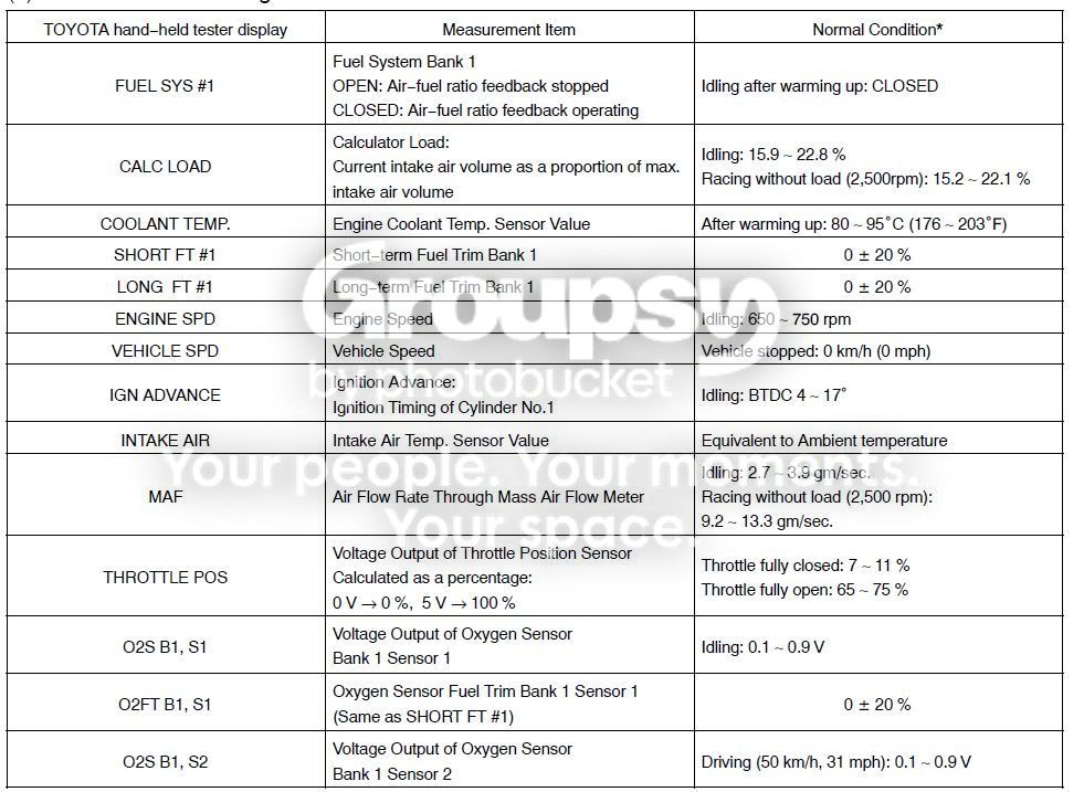

What's your tp1 read @ idle?, mines at times 9.41 and others 9.02, seemsbut then again its ten degrees out right now
the normal operating range for your throttle position sensor is something like 10%-75%. you should not expect to see it go from 0-100%. if that's the case there is something wrong. refer to your manual for exact #'s.
your supercharger has nothing to do with your tps. it's all in your foot homie.
Capture.jpg~original
picture taken from:http://www.dezertrangers.com/vb/motor-transmission/154949.htm
