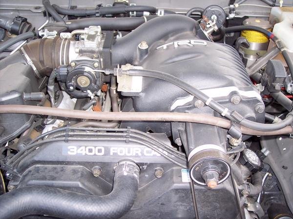

I was checking out the trd parts website and saw some special oil change kit for 4th generation superchargers (black). It said it recommended to change the oil inside the supercharger at 100,000 miles. I had never heard of this before and wondering if anyone else has a SC and if they've ever done any maintenance on it. I changed the SC belt at 55K miles. I am not sure I have a 4th generation, mine is black but was installed new when I bought it, July 2001.

As far as I know, there are only 2 generations of TRD superchargers for the 5VZFE. The first generation was grey and the second generation one was black. I'm sure it wouldn't hurt to refresh the oil inside the S/C, especially if what's been in there has been in there for 100,000 miles

the grey is third gen and black is fourth. why?!?!? I am not sure.
