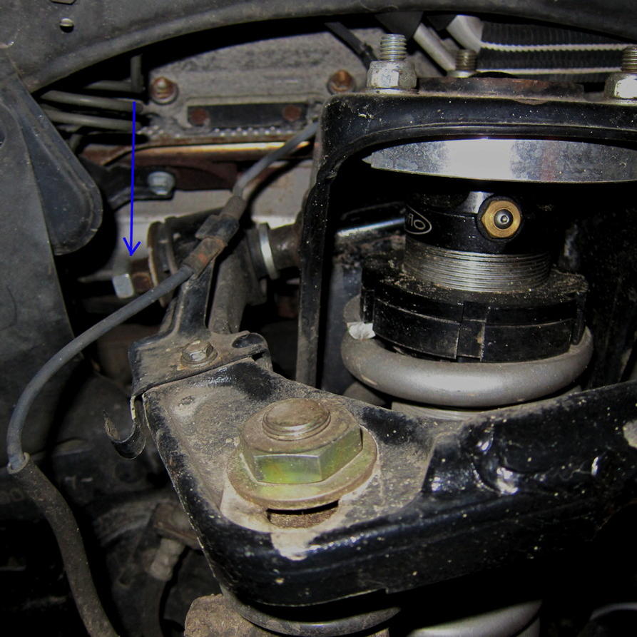

Holy SHIT [MENTION=77955]jdkilroy[/MENTION]! Went to check those nuts and found THIS on the passenger side:
The entire nut and washer were completely missing and the bolt was backing out. The driver side was still there. It wasn't 100 ft-lb tight, but it wasn't turnable by hand either. I think that it would really take a lot for that bolt back out enough to let the arm loose, since it would have to travel uphill while under shear forces, but it definitely walked. And in case anybody is curious, it's pretty hard to find these parts locally. Ended up just ordering the nut from Conicelli and washer from McMaster. Thanks for bringing this to my attention Jon.

I had the exact same problem happen to me, the first one happen on the driver side, I was lucky enough to have caught it, but for the passenger side I was unlucky, the nut and washer were gone, so I had to order the nut from Toyota and call spc for the washer, after receiving all the parts I when ahead and use loc-tite and mark it.
Yup, same as mine dawg. I'm taking the same action as well. Nut from Toyota, found a washer on McMaster that'll work (was close to calling SPC as well) and I'm gonna use some thread locker on them. Seems like a very prevalent issue.
And a very potentially dangerous situation! One dude's bolt backed out on a trail run and his wheel tucked into the wheel well. Luckily one of the guys on the trail has every spare part known to man and some to ape, so we were able to fix it on the spot, but imagine if that had happened on the highway? That would have been disastrous!
