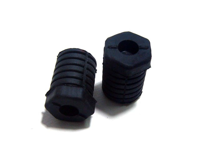

All you have to do is turn the rubber hood height pads clock wise on one side and counter clock wise on the other. I can't believe you couldn't figure this out.

Thanks I will try it. I take no offense as one, I 'aint exactly mechanically inclined (didn't even know there was such a thing as hood height pads) and two, the Toyota service specialist who's been working for 14 YEARS as a service technician didn't figure it out either.
According to the pictures, it appears the distance between the hood and top of the headlight is about the same on both sides. Measure the gap on both sides before doing any adjustment. If you make an adjustment, count the number of quarter turns on each side so you can return the pads to their original positions if this doesn't fix the issue. After adjustment, check to see if the hood is higher/lower than the nearby fender just behind the headlights.

Mine is the same. I have pulled and reset the upper grille hoping to improve it, adjusted the rubber stoppers and even asked my dealer about it. The dealer said they would be willing to dig into it, but was honest that tearing it all apart might not make it better in the end. I decided to live with it and not take the risk of having it torn apart. I think there is a lot of plastic between the bumper and the grille and the headlights, etc., and the parts are only so precise.
Resurrecting this older thread to ask the question: Is there any other adjustment for the hood - other than these two rubber height pads?

Responding to bring this thread back to life. I've installed the TRD Pro hood on my 2023 SR5. It is a capa certified hood and not OEM. I have this same issue. The sides are spaced evenly, and the hood is flush with the fenders except towards the very front. The hood is very slightly higher than the fenders in the front but the gap between the hood and grille is larger than other 4Runners. It seems like the gap is bigger on the drivers side like yours. Mine is black so it is not that noticeable, but I'd like to adjust it properly. I adjusted bump stops and there was a slight change, but the hood rattled then. I think the issue could be like was said above about the TRD pro grille install. I installed it on mine as well and I also had the bumper off again to install the TRD pro bumper valances. I'm going to try a more extreme adjustment of the bump stops lowering the drivers side and raising the passenger side to see if that helps and also prevent rattling. I have not adjusted the latch. I don't want to loosen the latch bolts unless someone can confirm that there is room to adjust them. I can't see that drilling is going to do anything good in the long run.
