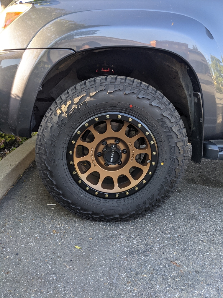

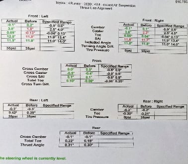

Got my 4rnr 2in lift, new wheels and tires, 265/70/17. Had to a little trimming on the mud flaps and front wheel wells. Everything was dialed in. Got an alignment, like I was told. The guy told me the he had to move the front tires forward a bit, the camber?? Not sure.. but he said it's rubbing more and I would have to re cut and do some adjusting. The problem is I don't think I can anymore, it's actually hitting the front bumper when I turn, ever so slightly. Do you guys think I should have them readjust the front wheel and push it back?

If you have them move it back it will wander all over the place on the freeway. I would say keep it how it is.
You can trim the lower inside lip of the bumper with a utility knife. Nobody will notice and solves the rubbing.
