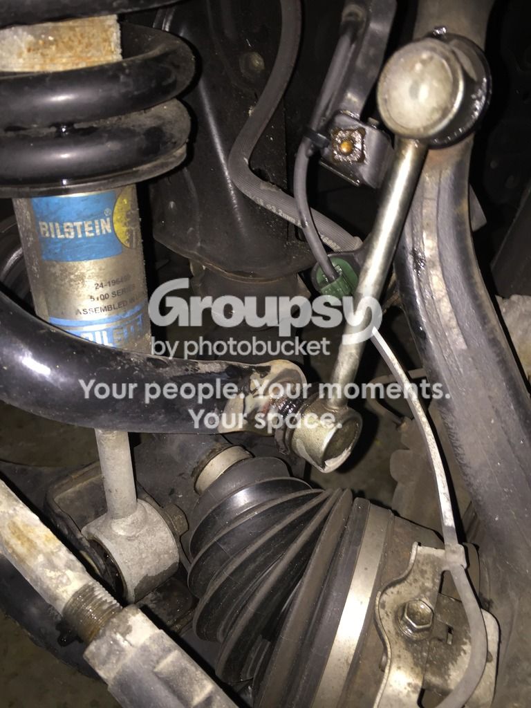

It's funny you asked about the alignment. I just had one done last week Thursday. Greased the ucas too!
Thank you for the help. When I did as you said the drivers was a little stuck. It also leaked some tan grease out when I turned it all the way one way... guessing that shouldn't happen... compared to the pass. Drivers was more difficult noticeably.
How should they be?
Yeah...there should't be anything leaking out like that in your picture! Maybe some "weeping" but not a glob squirted out like that lol!
