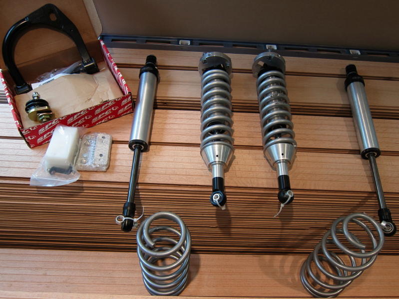

I'm getting ready to change out my suspension front and rear. I've done my research (tons of info here &120) but I'm wondering if you guys have any tricks or special tools that you use to make the job go a little smoother.
Such as: Spring compressor: make the job easier or really not needed ? (I can borrow one from local auto parts store)
Tie rod puller: I don't want to trash the boots or should I just get new ones and have 'em on hand? (I think I can borrow one of these as well)
I've got the hand tools, torque wrenches, first aid kit, duct tape, etc; and I've done loads of basic maintenance projects (brakes, rebuilt VW engine and such) I've just never done a suspension job.
I've also recorded all my base line measurements for stock/unloaded condition.
Thanks for any tips.
Here's before... after to follow:
Nothing special needed. I just used a couple good blows with a hammer to separate the ball joint for the ucas (after spending 30 minutes trying to separate it with a tie rod puller). Spring compressor really isn't required, but may help on the rear. A set of ratcheting wrenches is a big help for the front. Good luck with the install!
