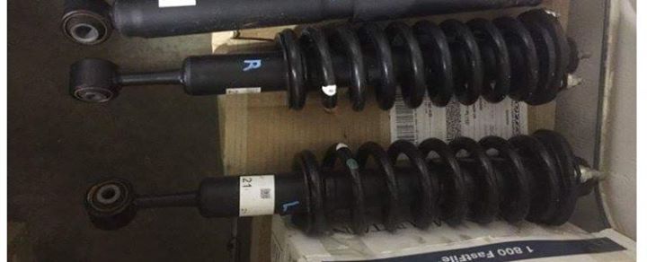

Not certain they will fit but I have a set of 2016 4Runner front strut assemblies complete ready to bolt in. Came out of my 2016 SR5 with 1400 miles on them. $75 plus shipping if you're interested in them.

Yeah, saw I was in the 3rd gen area after I had posted. Please disregard my latest post.

Those shocks are too long and won't fit. the coil springs will fit and will give about 1.5" lift
