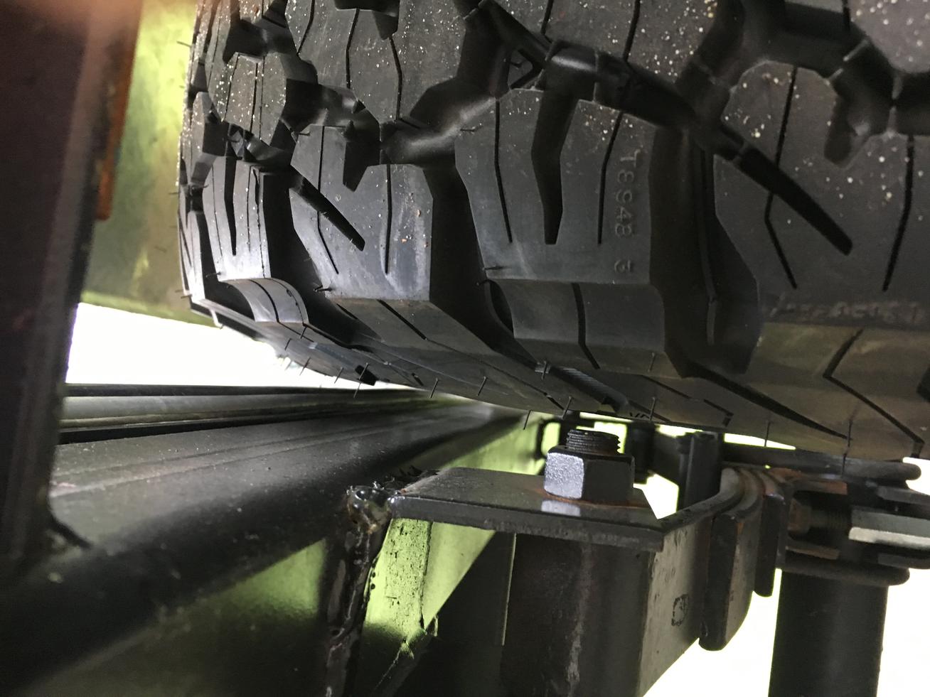

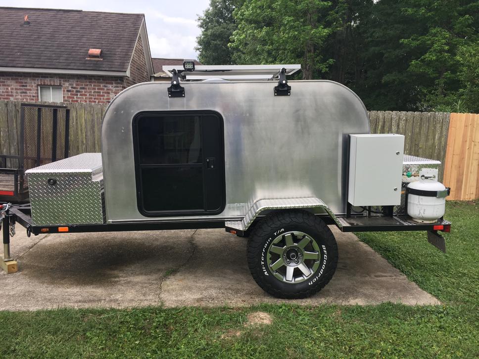

Need some advice on spacer for off-road trailer. Below is a picture of my custom built trailer. I added the Toyota rims (matching with my 4runner) and KO2 tires. However its a tight fit to the trailer frame, I need to add spacers or new hubs with different specs. You can see from the next picture how tight it is. Any one had experience on the proper distance for tire and trailer frame or the use of spacers on a trailer?

For those that might have the same issue. After many emails to spidertrax and Dexter axle manufacturer I got it worked out. The Toyota 4Runner adapter by spidertrax will work with the 6x5.5 idler spindle by Dexter
