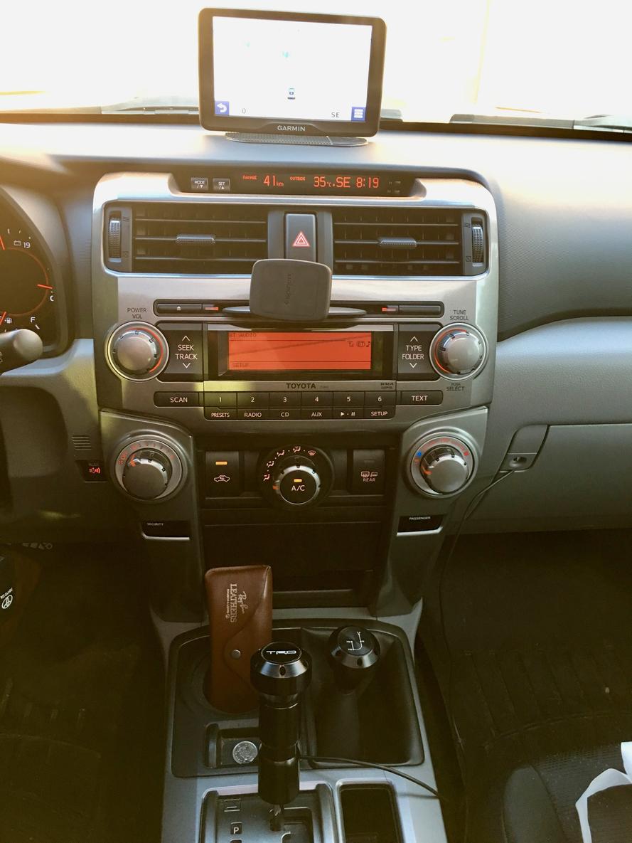

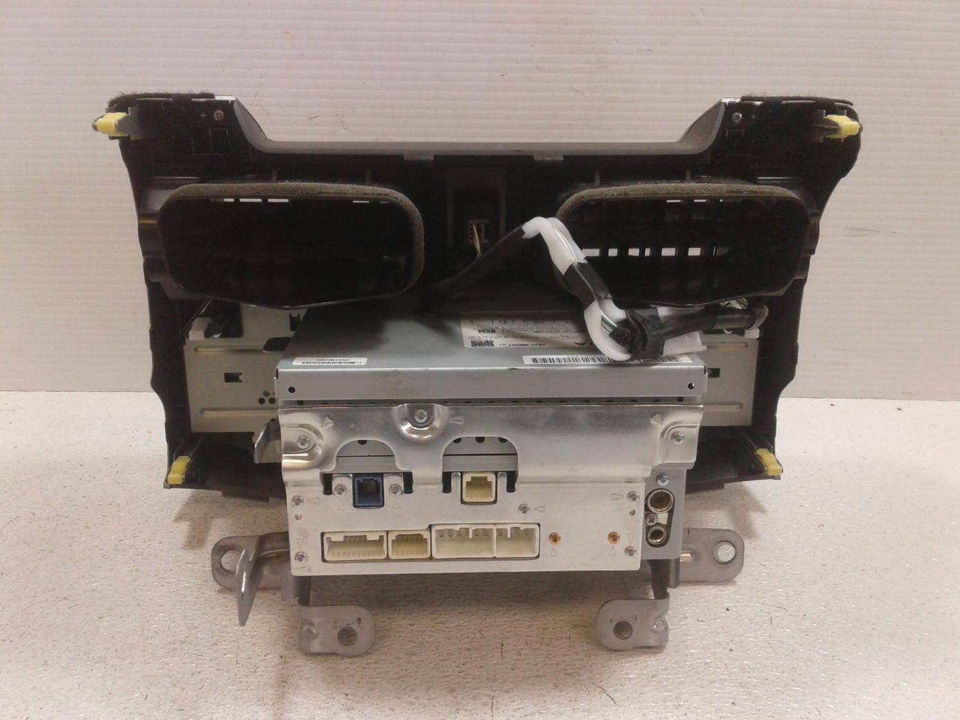

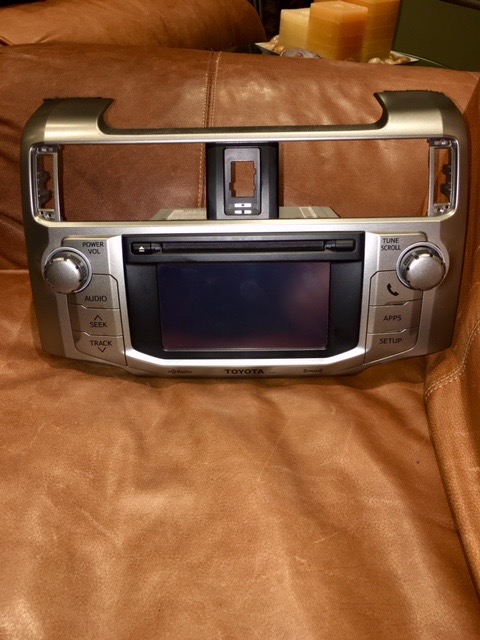

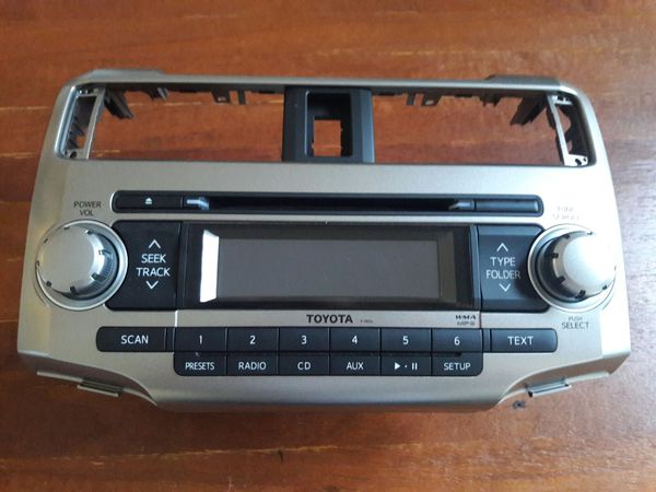

I have been looking to get rid of my 2011 Trails OEM radio without any LCD screen and NAV, and replace it with another stock radio with Nav/LCD screen from a 2013+ models. I just came across one at a decent price and before I buy it I want to get your opinions on the following questions? I am attaching a picture of the 2013 OEM radio. I also found a pic of the 2011 OEM radio (back) from the internet.

Here is the back of the 2011 stock radio.

Do the buttons light up orange still? I think it was 14 they went with white?
The orange gauges with red needles is one of my biggest gripes with the early 5th gens

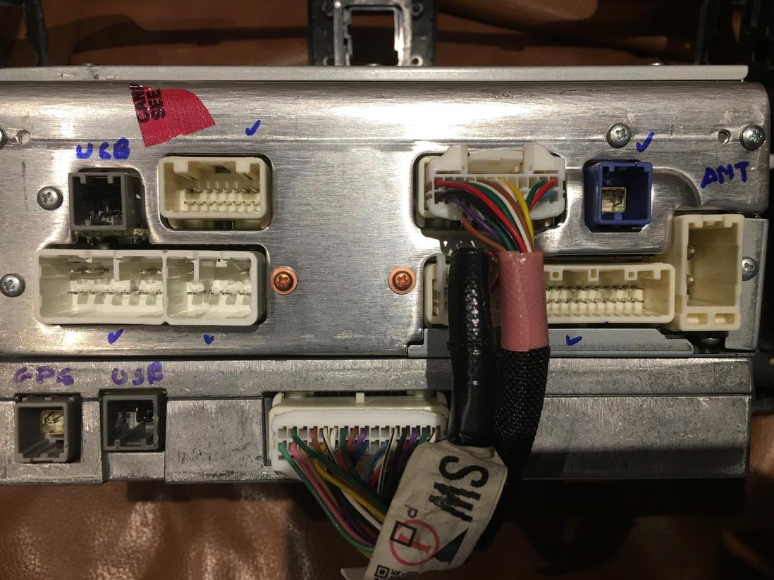

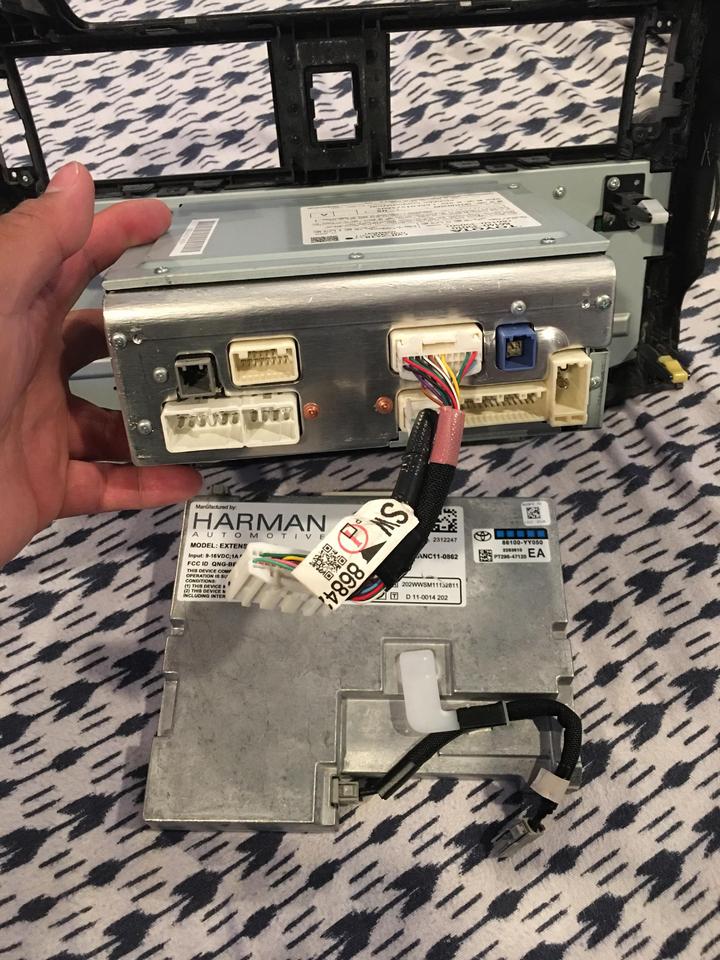

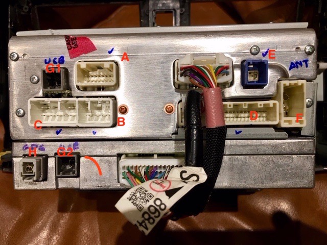

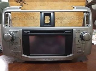

Ok folks... so i finally received the head unit today. It is a 2013 non-JBL, no-NAV, unit with LCD. it has an extension box attached at the bottom. I am attaching a few pictures
>> The first pic is the face of the unit
>> the second pic is the back side of the 2013 unit. I have labelled all the connection points.

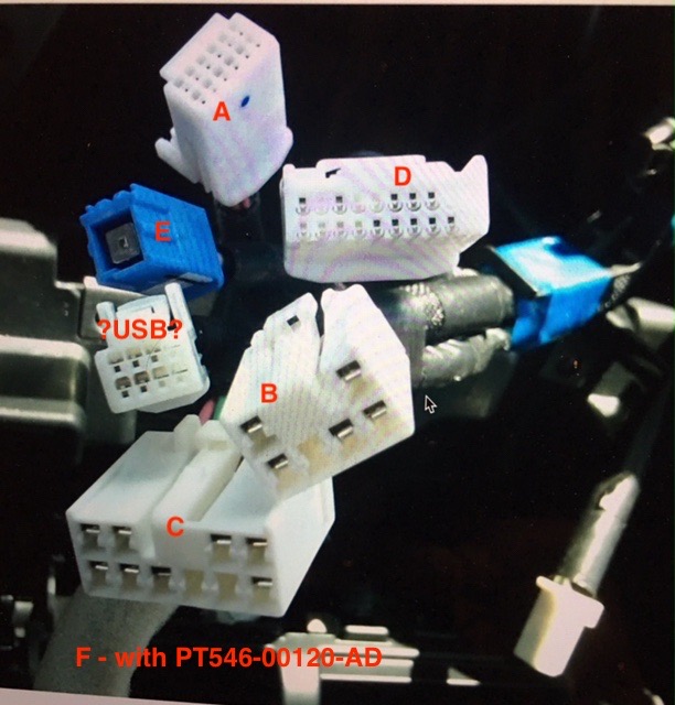

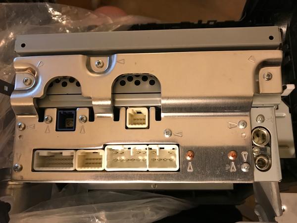

>> the third picture is taken from this forum. it shows how many wires are available in my 2011 TE once I take out the stock unit no-jbl, no-nav, no-screen

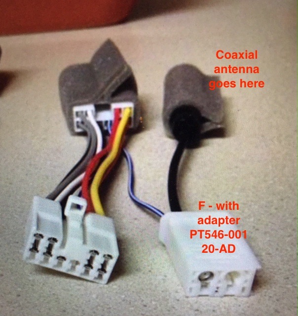

>> the fourth picture is to show you toyota adapter for converting coax antenna to connect with the new unit Part# PT546-00120-AD. i found this in the thread above mentioned by smallfry
I will do the install once I have the antenna adapter harness shown in the fourth pic.
QUESTIONS:
(1) what happens to the wire labelled as "?USB?" from my old unit? there is no place to plug it in in the new unit. Is that for USB? if not, do I need any adapter to connect it to "G1" or "G2" on the new unit? both G1 and G2 are identical. How does the USB feed get into the new unit?
(2) could anyone confirm that PT546-00120-AD is what I must have to connect the co-ax antenna to the new unit? is there any simpler method that I am missing out?
(3) What connection goes in "H"? the unit does not have NAV. but my best guess tells me that the GPS antenna goes in "H".
thanks. I will keep this up-to-date. BTW, when I bough the new 2013 unit I didn't notice that it didn't have NAV (not Ensure i guess also)... but that is fine as I have a 7inch garmin above the dash and often use Waze. no wonder i got it for real cheap.

now back to the wiring... the 11TE stock unit has SAT init. so where is the SAT connection on the back of the 11TEStock unit? perhaps I will find out when I open it up... so in the list of open questions...

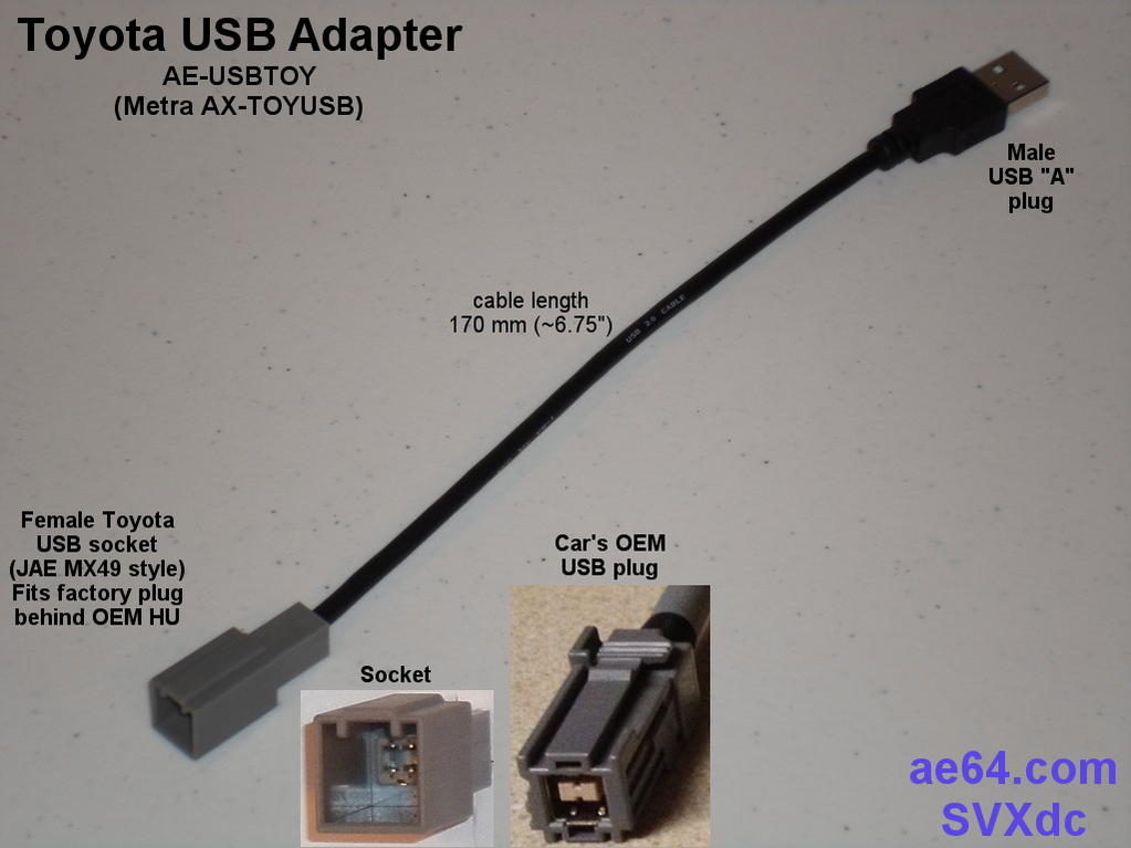

1) which port on the 2013 is the USB connection? 11TE has USB. Do i need any adapter like the attached picture?
2) which port on the 2013 is the SAT Antenna (see the latest pic here, i am talking about the bottom left hole... is it SAT for sure? 11TE has SAT too)
anyways, the best way to find out all of this is when i connect the unit and see what is not working.... just waiting for my am/fm coax antenna adapter.

I just bought those adapters from the one post and everything plugged in.
I just bought this OEM Highlander GPS antenna for $20 USD (ebay=> https://www.ebay.com/itm/192595990763?ViewItem=&item=192595990763 ). The deck came with a cut out connector (it shows in one of the pic above bottom left corner)... i just verified that i can open the grey plastic connector and attach it to the GPS antenna i just bought from ebay. Lets see how this works out. I didn't find any information on the net about the interchangeability of the OEM GPS antennas (among Toyotas or between Lexus and Toyota models). All part numbers of the GPS Antennas are different model by model.... so hoping for the best in case it work... not willing to spend more and NAV/GPS was never a priority for me 4Runner OEM GPS antenna retails for over $300USD min. Keeing it interesting....
so last puzzle now left is... where is the Microphone cable on both the old and the new deck? and where is the USB cable from my TE? .... does the cable labelled as "?USB?" in the picture above carry both the USB and the Microphone?

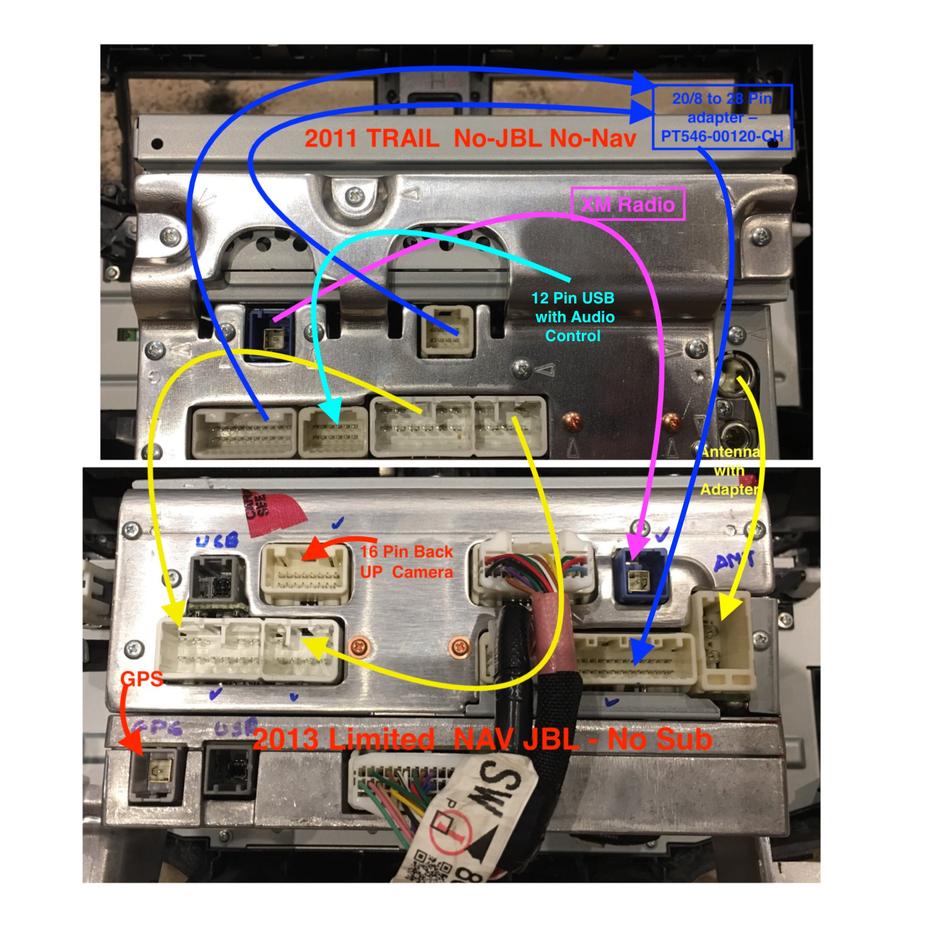

#1 PLEASE ignore the Wiring map I posed above. I opened up the radio to see what all wires were behind the radio today.
#2. I am attaching a new PICTURE of the wiring map. I am just waiting for a wire adapter from Amazon and once I have it I will do the install
#3. The GPS antenna belonging to Toyota Highlander arrived last week from ebay for $20. It did not have the end connector so I fixed it by connecting it with the end connector that came with the new deck (the buyer kept it on the unit for some reason)

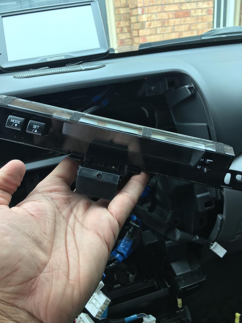

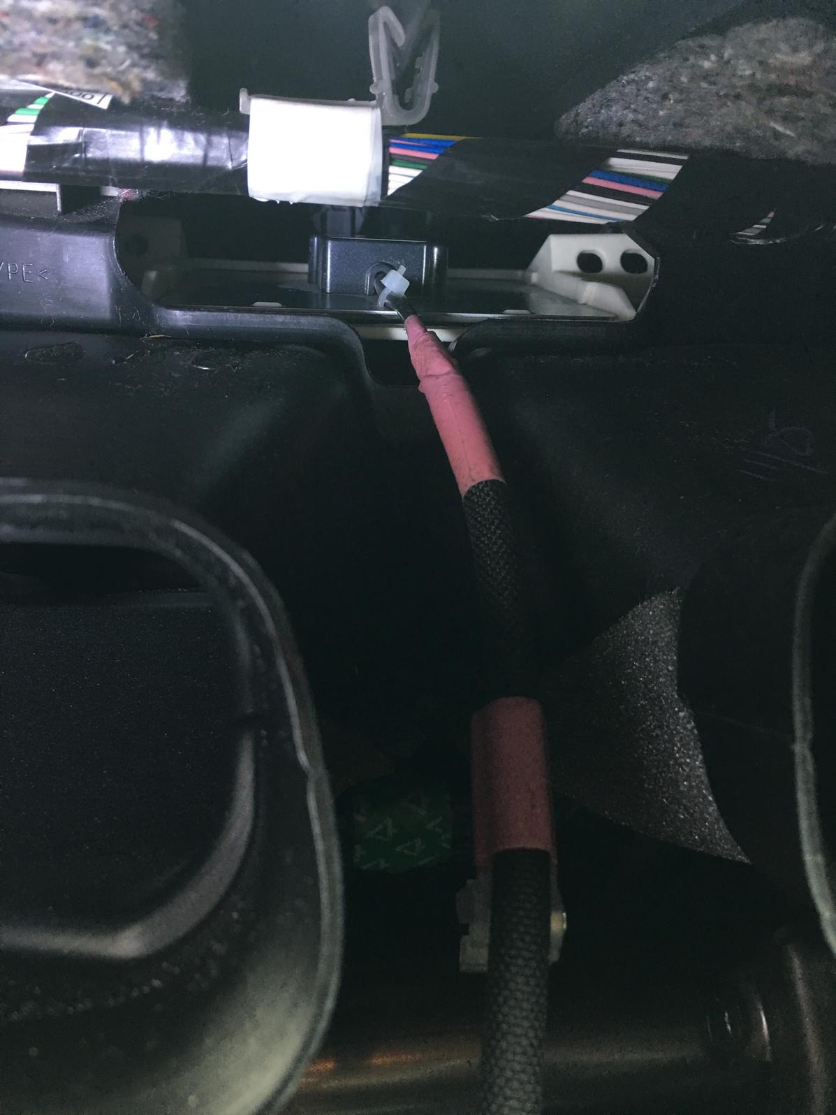

#4. I opened the digital display panel above the deck and figured out where I can mont he GPS Antenna (see the pic). I also opened up my 2010 Limited to see where the factory GPS antenna was mounted. it is exactly at the same place (above the vent and inside a plastic pocket. I just need to stuff some foam / sponge under the GPS antenna in my 2011 Trail
#5. there are two USB connector ports (the tray ones) on the new Unit. I am not sure how I can convert the 12-pin cable from my trail. I could not find any thing on the net
#6. the new radio has a 16 pin connector for the backup camera. I won't be tapping into the rearview display in my mirror unless it is a very simple process (also does anyone have any instructions?). UPDATE: i just found this info on how the rear camera => http://ae64.com/Rear-camera-16p-operation.htm

UPDATE:
I got the full install done. At the same time I added OEM+ 500Q reference DSP with a 8inch single sub.
*** working...
Radio AM/FM
XM Radio
All speakers via the OEM+ 500Q
Nav (using the highlighter GPS Antenna... yahoo... initially the map and the GPS pointer on the map was all over the pace.... needed to calibrate the GPS signal by driving around in circles... clockwise and anti-clock wise)
*** no working...
USB input
AUX input
this is due to one cable that could not be connected
Also the 2013 Limited non-JBL, NAV, LCD head unit did not end Remote-Trigger-On for the external Amp (OEM+ 500Q DSP Amp) to turn on. The 2013 Stock unit did. so I had to jump the cable. details are here => http://www.toyota-4runner.org/5th-g...t-wiring-stereo-amp-question.html#post3060769
