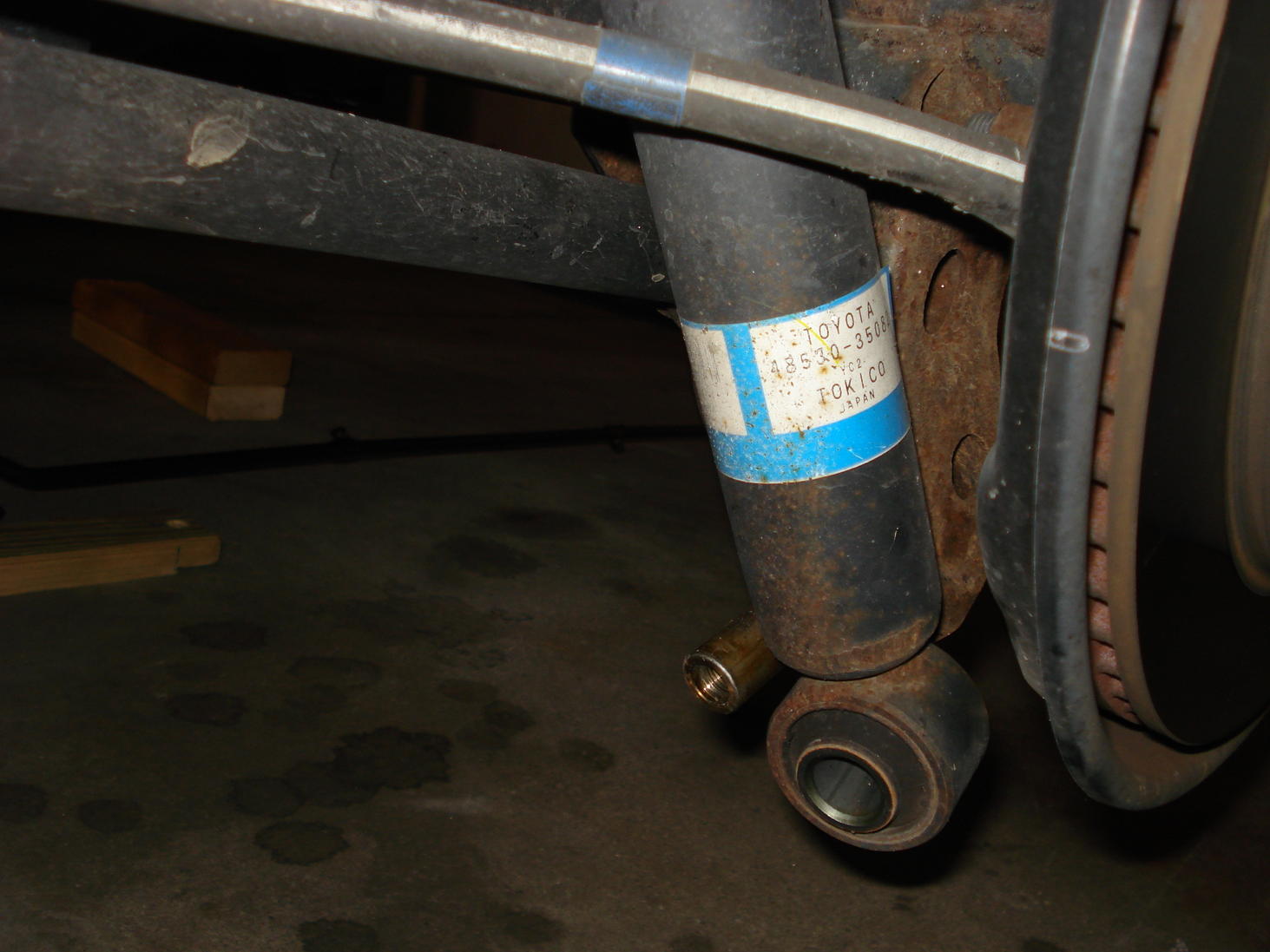

I just did my rear lift this weekend. The axel stud did seem to be at an angle that required a mallet to help it back on. Like the other post said, try unbolting your top link arm bolts. I took mine off with the wheels jacked up under the diff. I believe there is some tension/pressure there. That bushing and stud are both metal, maybe some penetrating oil would help too. Keep us posted. Best regards, Doug
Thanks for the encouragement!
I just finished the job 5 mins ago. The persuader was the ticket, along with some pb blaster.
