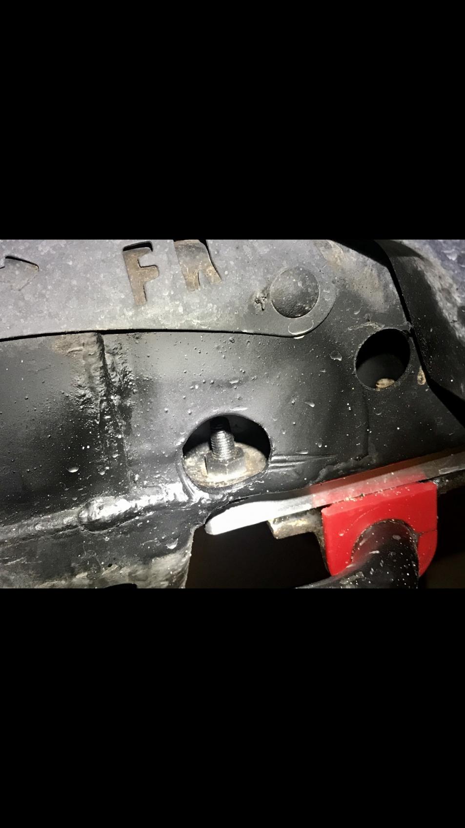

Hey guys. I got the Prothane bushings for my front sway bar and ran into a problem. For a little background, I bought this 4Runner in Salt Lake a couple weeks ago. Whatever creation of satan that they salt their roads with in the winter is just about the worst thing ever; it totally corrodes all the fasteners and makes everything impossible to unbolt. I hit the bolts with some WD40 and let it sit for a few hours, and while unscrewing the rear bolt from the driver side factory bushing/bracket, the bolt seemed to break. It spun freely, but was only about halfway backed out and wouldn't come out, which is what I would have expected if it just seized up and twisted off. So, after trying to figure it out, I removed all the other bolts, successfully, and got a better looks. It appears that there is a threaded insert that is welded to the inside of the frame, and I think the welds were corroded and the insert broke free. So the bolt is stuck, halfway out, and I can't tighten or loosen it. I installed the new bracket and bushing on the passenger side and tightened up the single working bolt on the driver's side, but I gotta do something to get the bolt with the broken thread insert fixed/replaced/tightened/whatever...
Does anyone have any suggestions? The only idea I have is to use a cutting wheel to cut off the bolt head, replace the bushing, and attempt to thread a nut onto the exposed threads of the bolt since the head will be gone. I definitely don't want to do that and lose that bolt inside the frame, though... I'll have that sucker rattling around inside the frame from here to eternity.

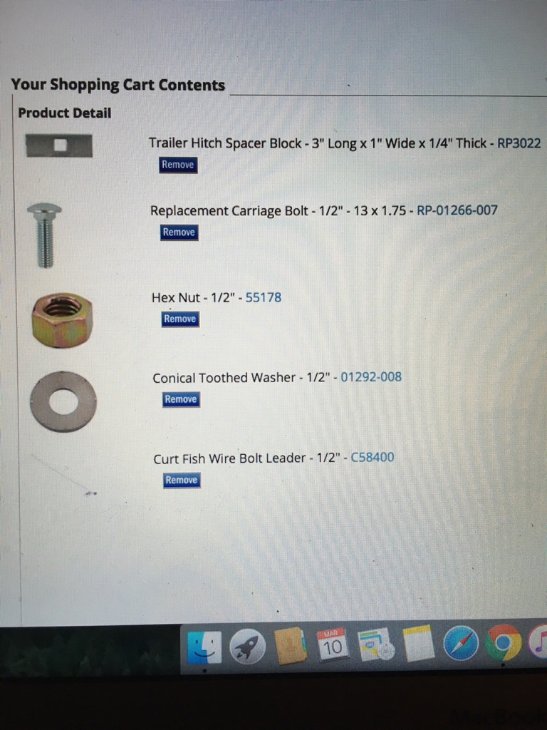

After doing some research, I found a possible solution following Curt Mfg’s advice for fixing the same issue for a trailer hitch. I’m having a local metal fab shop cut plates for a 3/8” (closest size to 10mm) carriage bolt. These are the similar parts sold by etrailer.com

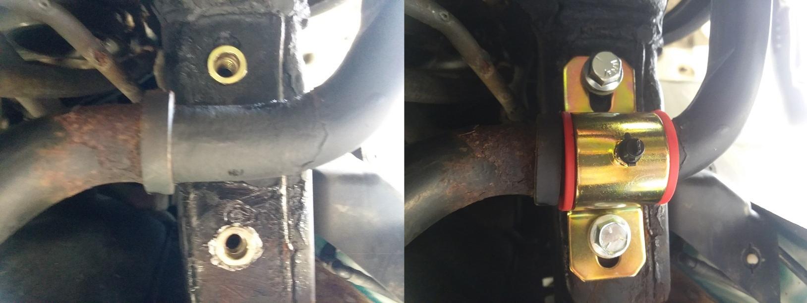

I recently changed my front and rear sway bar bushings on my 2006 4runner sport. I broke (2) 10mm bolts in the front and (2) 8mm bolts in the back. I was able to fix this by using rivet nuts. You can buy the kit with the tool, or you can make your own tool with a long bolt and a nut. Find this on youtube. You need to get the brackets that are slotted on both sides. Here are the ones that I got(Prothane Front 30mm 19-1186. Rear 21mm 19-1164). They come with grease fittings. Be careful that are not all the same diameter. Match your vehicle. You need to step drill new holes avoiding the ones that you can no longer use. Remember there is a nut welded on the back side from the factory. Avoid this with the largest drill size for the rivet nut body. Also make sure they are not too close together so that the washer from the new bolts don't interfere with the bushing area of the bracket. If you buy new bolts make sure that the socket for the ratchet is the same as the factory. 14mm for the front 10mm bolts and 12mm for the 8mm bolts in the back. This will be more forgiving on the new bolt location. I found out that there are (2) different size hex bolt heads for the 8mm bolt. This made my new locations in the back difficult to install. I was going to drill through the existing bolt with a slightly smaller US size drill and tap. I was able to drill all the way through at one location. Then I found out about the rivet nut. It was a much easier way to go. Granted still no fun but less painful. See Attached

I have had no issues. Working just fine. Another tip. I took a dremel tool with a metal cutting disk and cut through the slot on one side of all of the new brackets. Making the one end open. Instead of the closed slot.This enabled me to get one of the bolts started and slide the bracket into place. Good Luck.

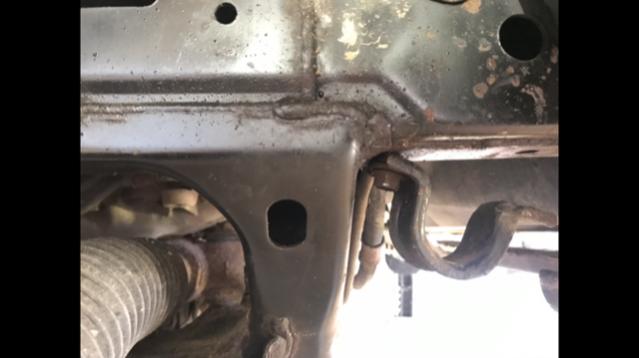

The same thing happened to me on Saturday. It was on the passenger side rear bolt. Was wondering what the heck happened as it looked like the frame itself was threaded but the bolt only coming half the way out. Had to pull out the bushing with pliers and jamb it back in with a screwdriver to get it all back together with only 3 bolts holding together.
I’ll order new bushings and take the advice from the thread to get the 4th one in and tightened. I’ll report back when I get it. Truck is a 2008 and came from NJ & PA with a good amount of rust and some terribly stubborn nuts and bolts. It has 154,000 and only had it a couple weeks.

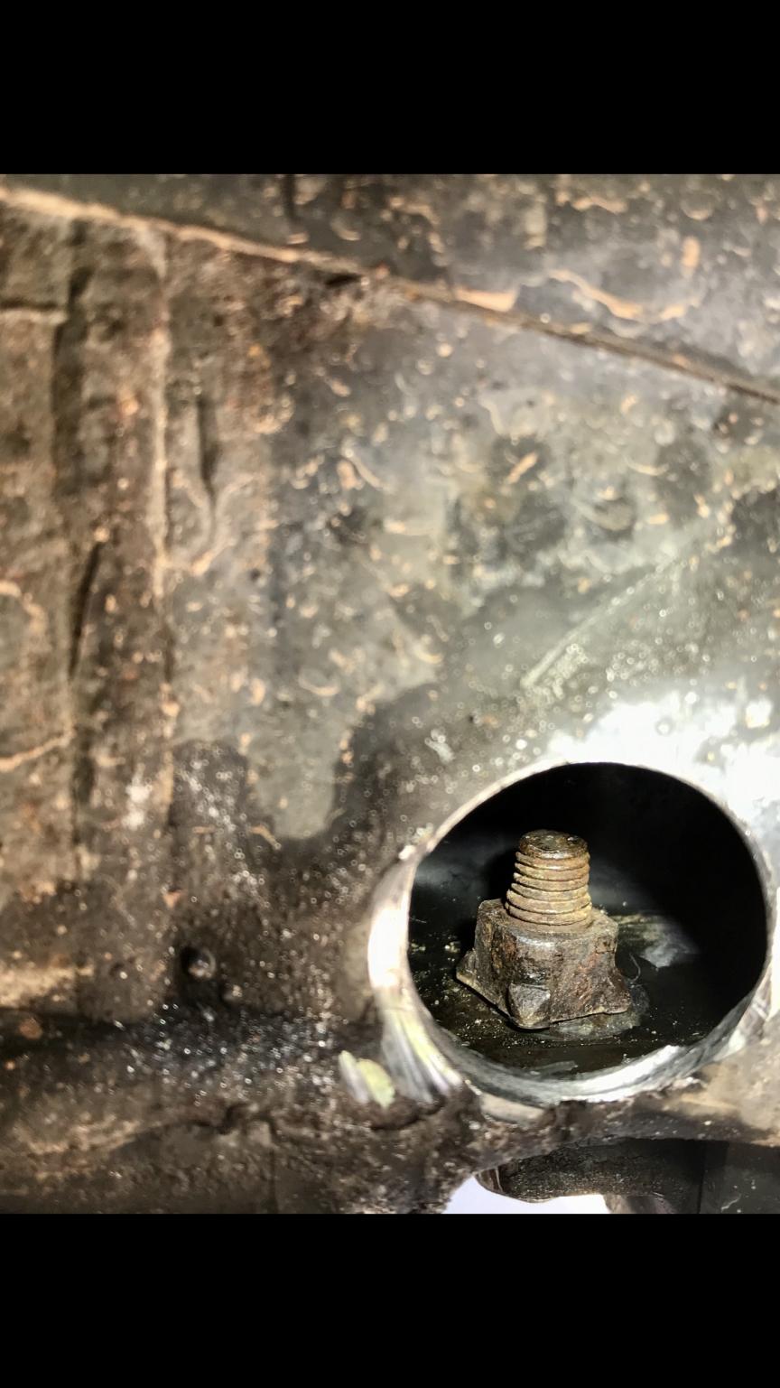

I just went through this. Thought about the Rivnut option but unless you did front and back it wouldn’t be level, then left side would be a different height too (probably doesn’t matter). I opted to drill my frame with graduating bits and used a Christmas tree bit. I had to dremel width wise a little more to get the open end of a wrench on since it’s a square nut.
I just bought a new nut and dropped it in, this way I could get a box end of a wrench on it. Considered maybe tack welding it in place and sealing the hole. For now just replaced and primed. Since I was replacing it I replaced my bushings with red energy poly Both front and back.
