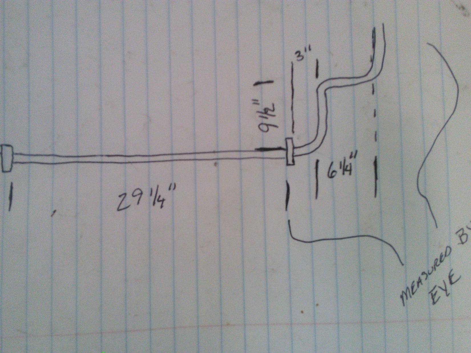

[MENTION=66389]BlackWorksInc[/MENTION] so here's the deal. Only 1 guy had his SB still on, bad news is he wasn't letting me remove it. So he had his skid off and I did the best I could at eyeballing the measurements. The stopper ring for the bushing area is .5" wider than mine v6.
Ruff measurement I can see is 47.75", which is 1 3/8" +/- wider. Might want to find one and do a better comparison.

Thanks, that's what I was getting with a tape measure when I was eyeballing it as well. Hopefully we'll have a Tacoma that has some work where the bar has to come off and I can take a quick measure in the near future.
