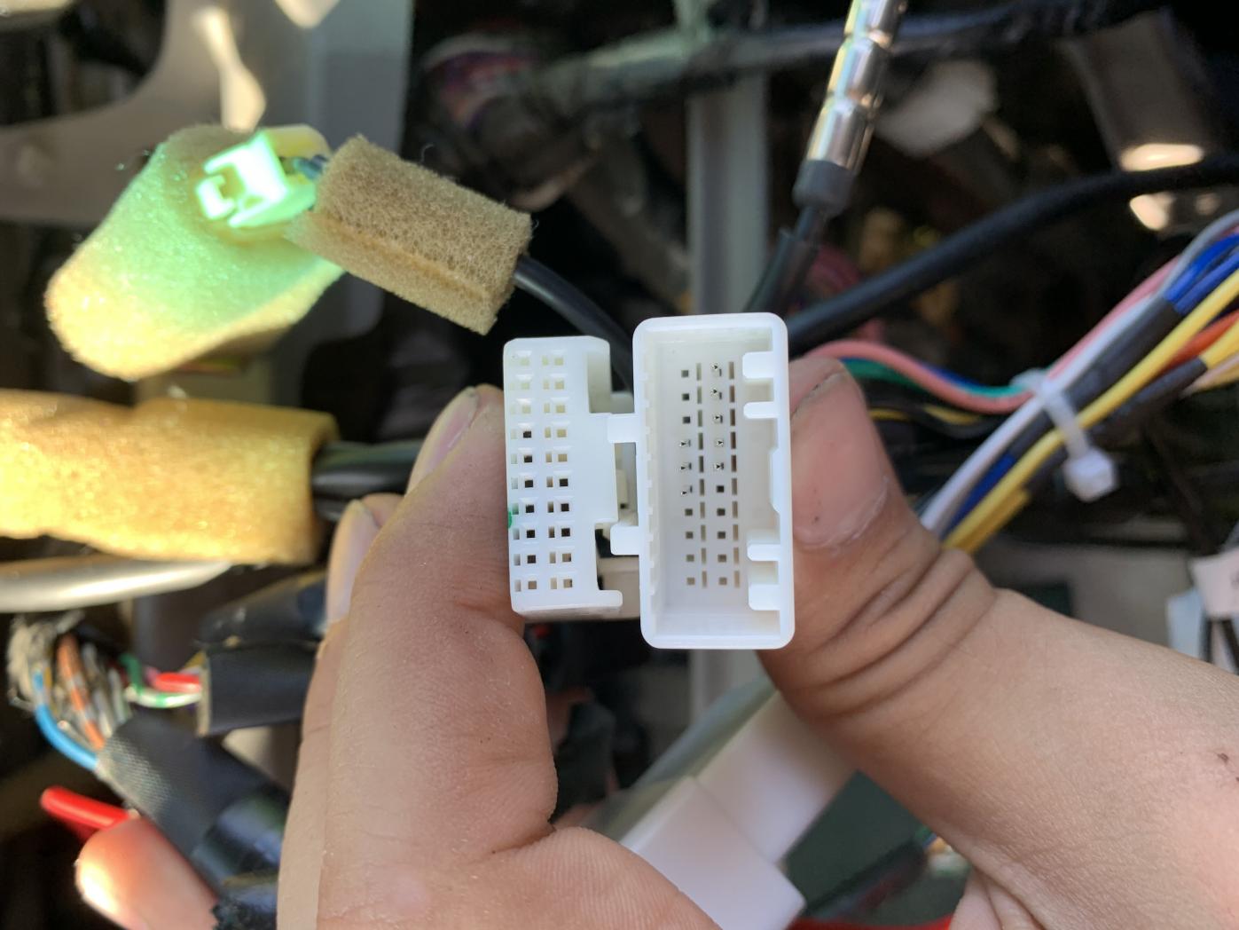

Hey all, so I've tried the Crux SWRTY 61j and the crux CS-TJ20. Both ended up looking exactly alike btw. Anyways, the main connection works perfect and the head unit works, but I cant connect the second harness clip because the pins dont line up (Picture below). As you can see the pins dont match up and there's 6 on the oem and 5 on the crux. Now I can't use my steering wheel controls and it's a bit frustrating. Anyone recommend another harness adapter kit or have this same issue?
05 4runner limited w JBL speaker, RDS, no navigation
Ok so I'm a bit of an idiot. The crux harness does work. Shoutout to riceandpho for teaching me that only 3 of the pins are what powers the steering wheel controls. So all the extra pins are what makes it "universal" for every damn toyota with JBL. I also programmed the wrong brand headunit on the switches so those two fixes got my SWC working. smh.
