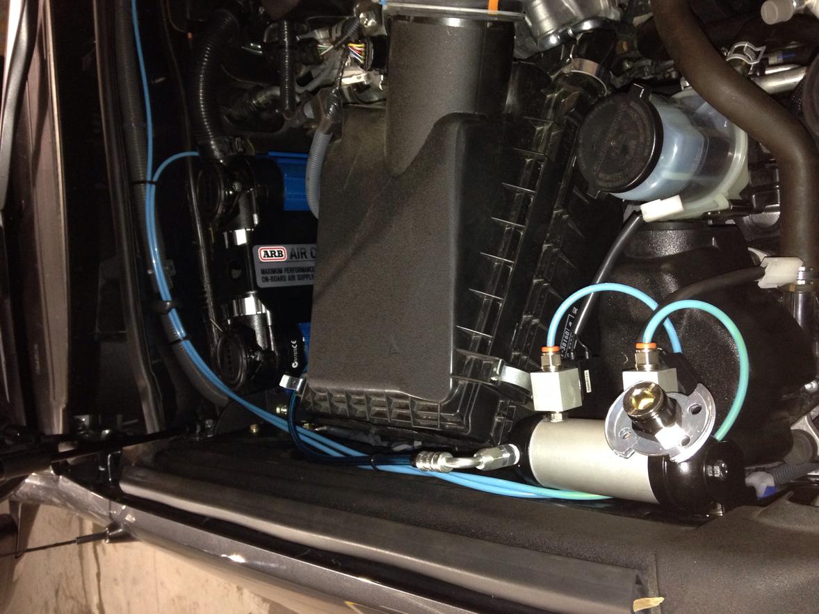

Picked up my rig yesterday from ECGS. They did an awesome job mounting up the compressor and manifold... Very pleased. This thing is stout!
Tomorrow or Monday I'll be doing the electrical wiring on everything.
Here's a shot under the hood.

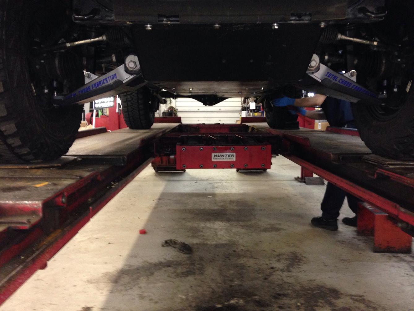

Haven't updated in awhile. Went up to High Tech to get my suspension squared away and my TC LCAs installed. Everything worked out nicely and now my alignment is awesome!
FYI the clunk noise I had been hearing was from my driver side UCA shifting. It sounded for sure like it was coming from passenger side but it wasn't. When the original joke-show shop (Production Off Road in VA Beach) initially installed the UCAs they used two of the proper washers and two of the (thinner) OEM washers. This caused the overall assembly to not extend to where the threads stop on the UCA long bolt, so even though the nut was tight, it wasn't tight against the entire UCA. Scott identified it and got me all set up.

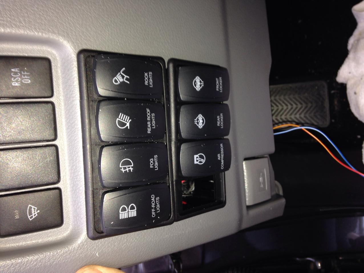

Finally got around to installing all the electrical work for my compressor, lockers, and winch. This isn't the absolute finished product (I cleaned it up a lot), but you get the idea.
I haven't finished mounting the winch relay and fuse so that's still to come. Still looking for a good somewhat weatherproof location for it.

First the bad news- all those switches in that picture are sideways...

Haha that's why I said I cleaned it up! That's not the final shot. They're looking pretty good. I'm actually contemplating using some kind of non-permanent adhesive to fit the switch brackets very flush in their mounting locations. Any suggestions?
Thanks for the compliment. I'm wondering how it would do if I tried adding some solder to the connection points to give them a little height?
