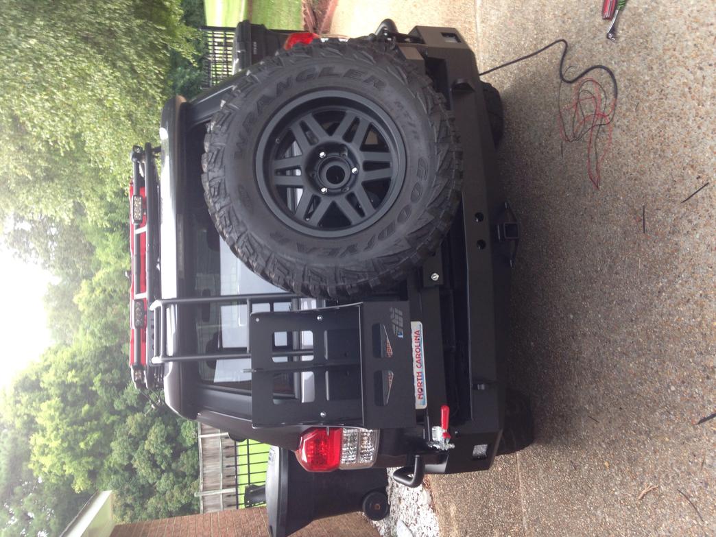

Almost done except for wiring the license plate light...

Looking good. How did your clearance issue get resolved? Did you end up tying into the tail lights or the trailer wiring?

I Dremel'd out some of the mounting holes to elongate them toward the forward part of the truck. That was the sticking point that wasn't allowing my bumper enough room to come rearward and clear the body panel. To hold it on and keep it taught while I tightened the bolts I double trucker hitch'd the bumper off my Tacoma.
I still haven't done the license plate light wiring... Thinking of moving the location of the light itself underneath the can carrier. As it sits now if the light were on, it really shines to the driver side a lot. Could be annoying for people at stop lights... but then again, so could 14,000 lumens of HIDs if you were in a lowered Prelude 2 ft off the ground.
On another note, if you have a Gobi ladder, the fold-down camp table will NOT be compatible with your setup. Mine wasn't even close and now I have to return it.
