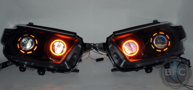

Oh, and last week I put in the work order at Black Flame Customs to get a HID projector retrofit done on some headlights. They're doing them on another housing, that way I won't have to take mine off. Let's just say this... they won't be like anything you've seen on here yet :D
So are the halos different? or shrouds different?
Why the difference (other than placement) from inner to outer ?

Sooooo... headlight build is done. To say I'm excited is an understatement.
My favorite picture is below (credit for photo goes to BFC) but also check out the link:
2013 Toyota 4Runner Quad FXR MH1 Projector Retrofit with Quad Amber Halos | BlackFlameCustoms.com
What do you guys think? I went with the amber halos because I'm going to wire them in to come on same as my DRL/turn signals. Really looking forward to it!
