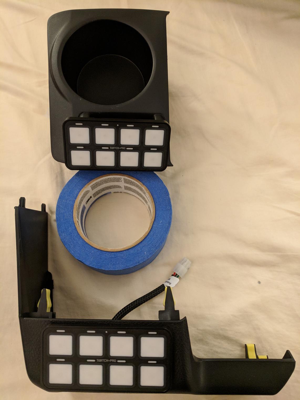

i bought the sdhq mount. its a good look, can probably diy, but i dont i wanted to get this in and out.
for the sp8100, i previously starting putting it in the coin holder in front of the shifter. had it mounted with a magnetic phone attachment.

You're going to love the Switch Pro unit. I have the SP8100 and used the SDHQ mount for the actual switch panel unit. I have an installation guide here if that could be helpful to you.
http://www.toyota-4runner.org/5th-gen-t4rs/247222-sdhq-switchpros-mount.html
This was a great OEM like fitment and I've now had it installed for about 4 months with no issues.
As far as the engine bay mounting, putting it on a power tray will keep things nice and clean. I would have gone that same route if I didn't have my ARB compressor on a Slee mount which places it where you'd install the power tray. Good luck with the install!
Currently installing mine onto my new Power Tray main electrical panel, and I am doing a full write up that will be available soon. Functionally, there is little difference between the 8100 and the 9100. There is an increase in power over the previous unit, and some additional features such as multiple button panels per main unit. More info on their website for specifics. IMO the SDHQ mount looks very OEM, but it's low on the dash making it hard to use without taking your eyes completely off of the road. Just something to consider. I will update more with the install as I complete it.

Decided to use the sdhq mount. Instead of the one I rigged to for the 8100 I never used
