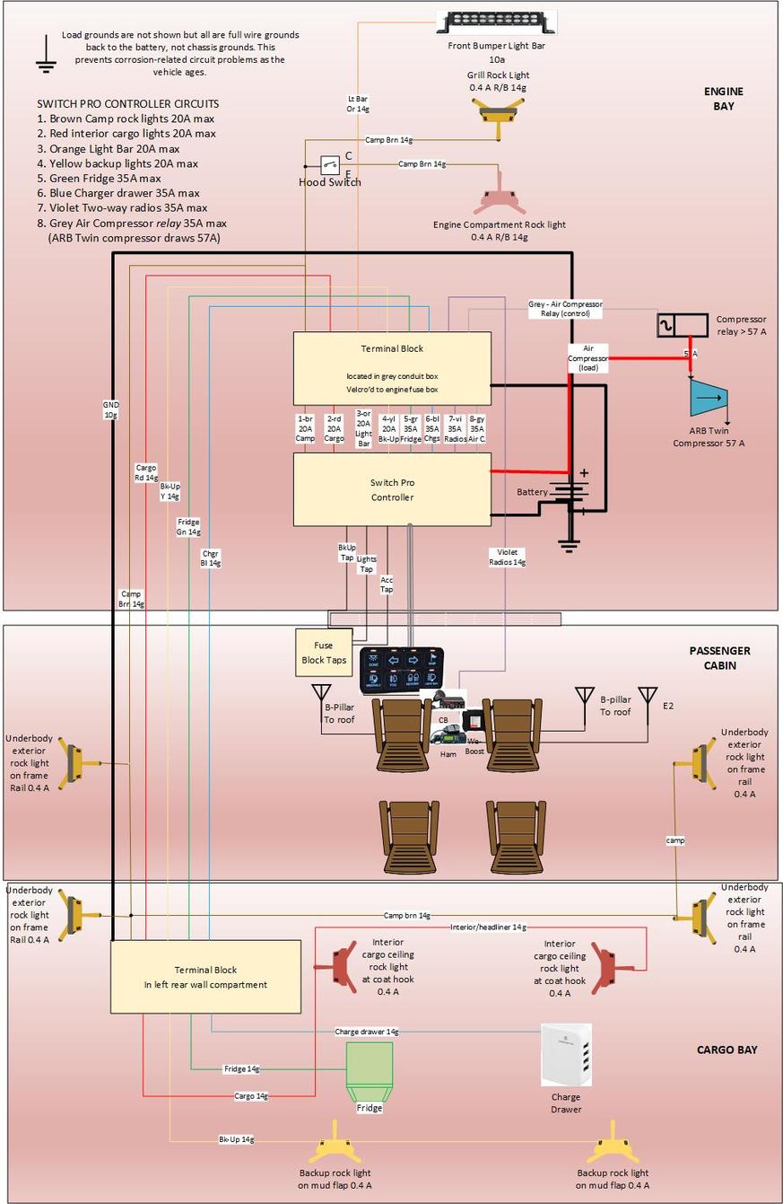

I connected the hot wire directly to the battery lug, and the negative to a ground lug I mounted next to the controller and grounded to the battery.
All my load circuits use a full ground wire back to this ground lug, never a chassis ground, to avoid corrosion and vibration related problems later. Many electrical problems can be traced back to the use of multiple different chassis grounds.

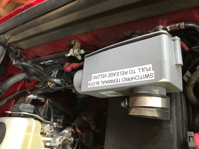

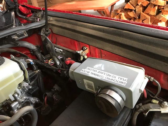

I've got the SwitchPro 9100 mounted immediately aft of the engine fuse ox on the inner wall, with a terminal block from Home Depot handling all the load connections in one easy-to-see place. I then enclosed this in a conduit box for protection and mounted it atop the engine fuse box lid. The result is compact and easy to diagnose and add to.
For the ARB Twin, use a relay, since it draws 57A and the max a SwitchPro circuit (5-8) can handle is 35A. Most everything else can be run directly off the SwitchPro circuits.
I'm an engineer/nerd, so here is my wiring diagram.

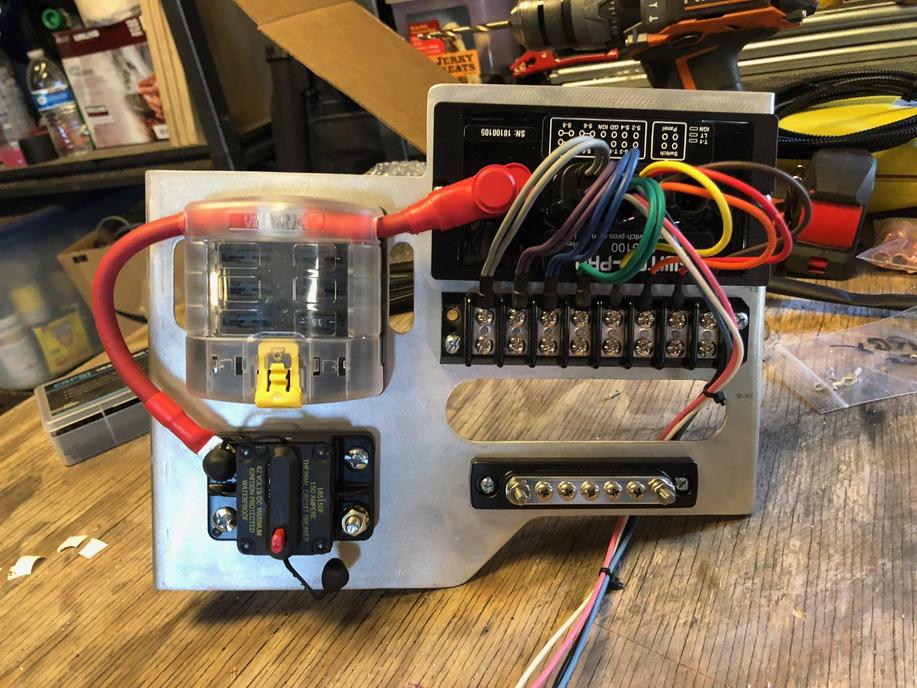

Thank you, I hear what you’re saying. My thought on that was; that breaker, or the supplied 125A fuse even, is not the only protection for the unit. Each circuit has the internal MOSFET protection. Since I’ve added a small fuse panel, I upped the breaker to 150A to protect that load as well.
I’m definitely not a pro when it comes to electrical, so I really appreciate input on this. I called Switch-pros on a few of my questions. Their concern was that the unit must see 12V and I “think” I got that covered.

I'm running a 150a MRBF to 120a circuit breaker on 2awg wire to sp9100
125a mrbf to 100a circuit breaker on 4awg wire to 8 bluesea 8 circuit st.

I’ve got 2ga. Running to the panel. The short runs are 4ga.

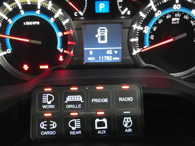

I've finished installing a 9100 in my 2018 Offroad Premium, and it works beautifully. Here are a few tips:
I located the switch module on the top of the steering column at an angle, where it sits beautifully. I can see it clearly, and the color wheel allowed me to match the dash gauge colors perfectly. Since I rarely hit switches when I'm in motion, it does not interfere with steering.

In both the engine bay and rear wall bay, I used a Home Depot terminal block (like the ones pictured in this thread) and enclosed it in a largish grey conduit junction box with a rubber cap from the plumbing department, then used industrial strength velcro to attach the boxes securely to the vehicle. Works great, protects the terminal blocks from damage.
Strobe, dimming, flash, timeouts and bluetooth all worked brilliantly out of the box.
Thumbs-up for a great product.

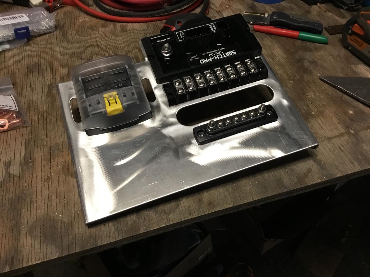

In terms of the picture, you don't really need the bluesea fuse box. I would recommend the terminal block and ground bus bar as it will make your wiring neater and easier. Although both are not necessary. The terminal block just lets you easily disconnect/connect the power wire for the accessory that you're trying to connect. However you could also achieve this with some spade connectors. That way you can easily disconnect the spade connectors and wire in new accessories or switch up the configuration to the switches.

I bought the Power Tray for the 9100 and a single ARB compressor because I felt this was a great use of space and function.
1. Easy access to Switch Pros
2. Great placement of Switch Pros for running the wires to the cabin.
3. Single compressor meets my needs
4. Blue Sea fuse box. This allows you to power things with a constant power that you don’t want to use a switch for. Like underhood lights with its own switch. Or Mtn4rnr great mod, who needs a grab handle. Etc.
5. Terminal block. MUCH easier to connect and add whatever vs. splicing wires. And much cleaner install. Easier to take off as well.
6. Common bus bar, same as above. All your negative wires go here. Switch Pro or fuse box. Much easier and cleaner
7. Custom cables for your battery. Made the right length.
Anyway, lots of great functional reasons, plus a cleaner more organized engine bay.

The bus bar and terminal block just gives a nice, clean place to wire up the positive and ground from your accessories. With out those you would still have to ground them out somewhere under the hood. I followed MTN4RNR's article on my install under the hood.

You're correct, so the wires coming out the harness for each switch go to one terminal of the terminal block (sometimes two wires to one terminal for the 30A switches). When you're wiring your accessories, you'll wire your power to the other end of the terminal block coinciding to the switch that you want to hook it up to, and the negative to the bus bar (you can attach it anywhere to the bus bar since it's just a ground).
What mount did you use? Looks bugger than powertray. I like the idea of a smaller fuse block and the added breaker. Does it fit into the same location as the Powertray setup?
I made that mount myself. It was just covered, but you really don't "need" anything other than the actual SP9100 module. you could simply attach it to the firewall and splice wires as needed. I ran the small fuse box, because I'm adding constant power toys, as stated above. The terminal blocks are simply for the ability to change things around if needed and keep a clean appearance.
